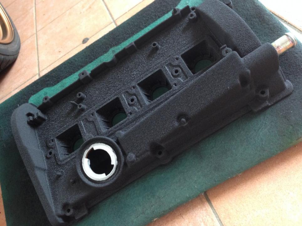

                  • Decided to paint the valve cover wrinkle black
                    Decided to keep the evap but I deleted the line going the the intake manifold, I figure vacuum from the tip should be enough to pull fuel vapours through.
                    • looks neat mate!

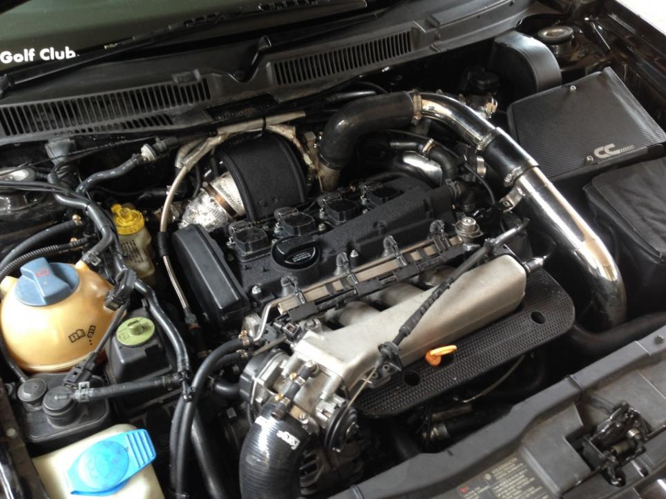

                        Thanks mate. I decided to clean out the pcv system as well while I was there as it looked pretty funky, I wasn't wrong!! So much crap came out! Also discovered my boost leak, damn pcv is leaking, I don't think they like high boost as it's only 4 months old. By-passed and got my 4 psi back, forgot how much fun the car is when I have full boost . Now I gotta order a billet pcv valve from 034 but they want $40 to **** a $30part here anybody want me to throw some stuff in the order for them and split postage?
                        • Love the finish. You need to do the intake chamber now, or polish it up?
                          • Thats lloks good! I want to do mine now..
                            how did you diagnose the PCV? I have a boost leak I cant find, possibly my issue as well.

                              Thanks mate, yeah I wanna do the intake manifold as well but need to decide if I'm gonna upgrade it or not. That new one from IE looks boss!
                              I took it out and literally blew through it and could hear and feel the air leaking. Want me to order one for you as well? It wasn't leaking that bad but it was still enough to rob me of 4 psi. I've been chasing that leak ages, I've probably checked every clamp in the system and it was that damn valve haha
