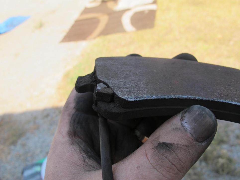

                    The rotors had a very small lip but looked like they would probably have survived another set of pads without any issues... maybe machine off the lip? But since I had all the parts the old ones are now in the boxes in the garage for later inspection.

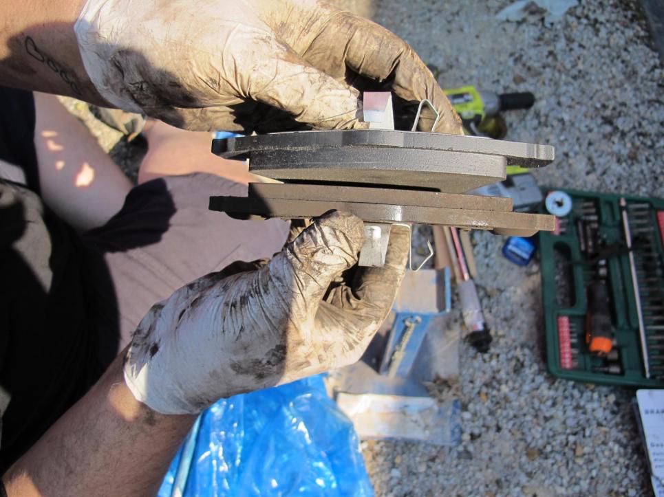

                    Even the pads dont look that worn down to me:
                    But then that wear indicator thing is just about there (the new ones have a huge amount of pad above that!).

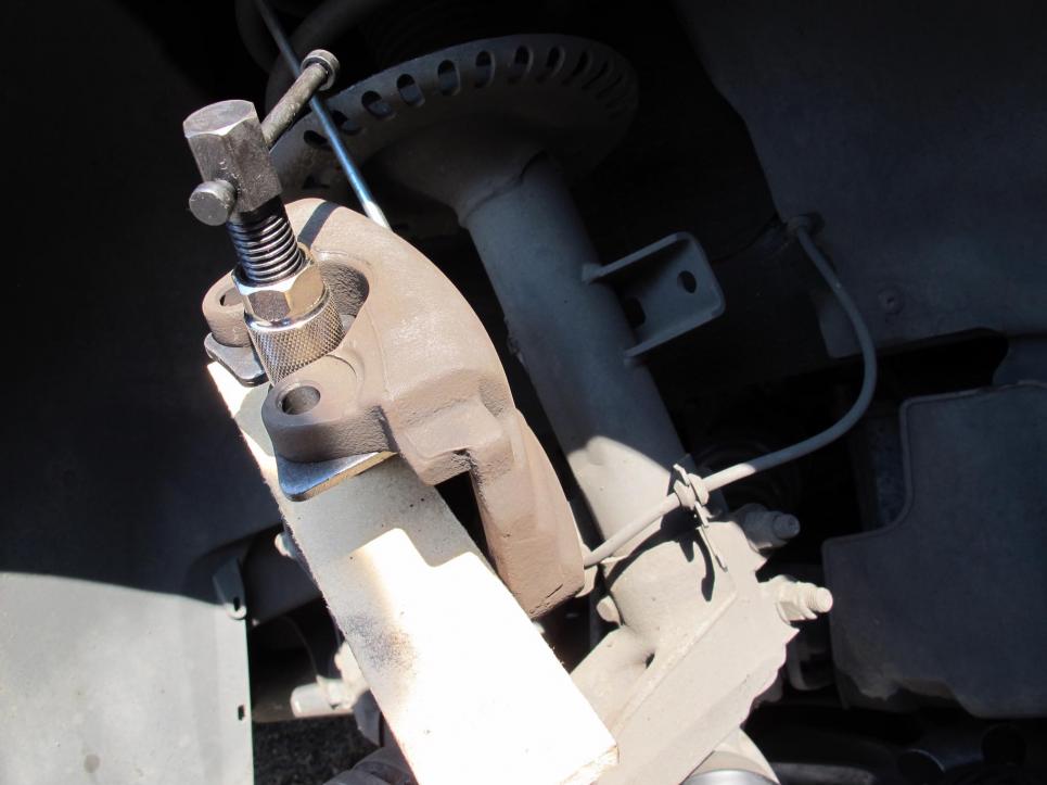

                    My eBay tool worked fine with a small block of wood to push the fronts pistons back in:
                    The rears thought presented a problem with the little pins needed to screw that piston back were *just* too close together, but a little gentle modification using my dremel trimmed them back enough to engage and work without problems.
