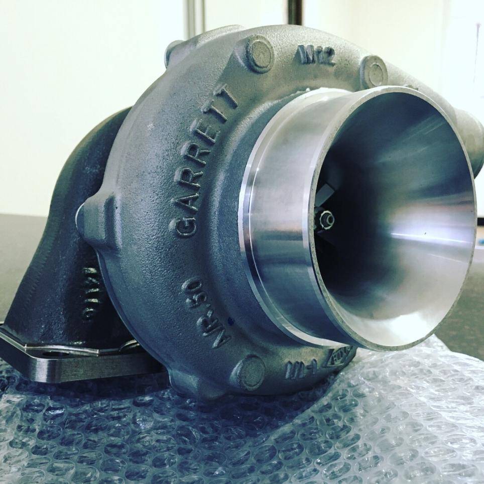

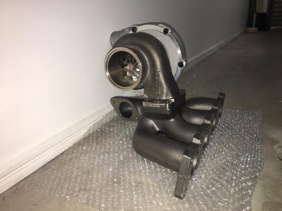

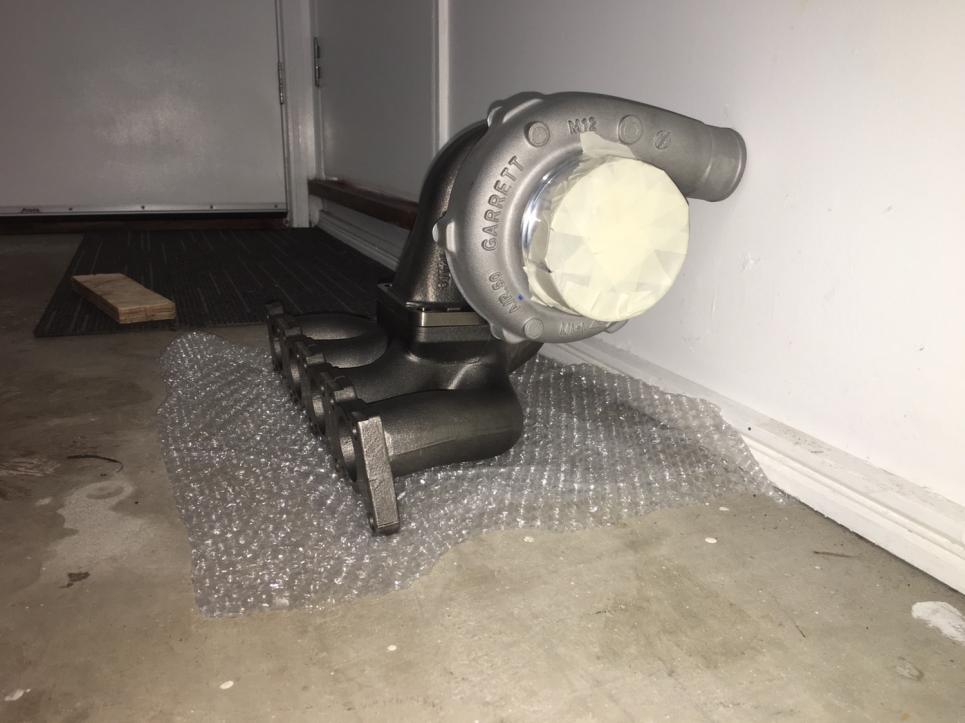

    So here it is, the start of the new chapter for the polo and I. Recently I purchased a second hand engine from Sydney which will be the base of the build I'm about to embark on. The new engine has just 74,000kms on it (which is 100,000k less than my current engine). Over the past few months I have been collecting bits and pieces while we were in the process of purchasing our new house. I still have plenty to buy but will be buying those parts in the coming weeks.
    The new setup for the the car will be as follows:
    - Garret GT3071R .063 Turbo
    - Bartek Top mount manifold
    - External wastegate
    - Plazmaman single pass FMIC with 2.5" pipe work
    - Bosch 1000cc injectors
    - IE forged rods
    - Calico race bearings
    - ARP bolts
    - ECS Stage 2 Clutch and lightened flywheel
    - New custom intake
    - New Downpipe
    - IE Intake Cam (once they return in stock)
    I'll leave the head stock for now other than porting out the intake side, with the option to build it up later down the road. With this new setup I think a ball park figure of 400hp is where we will aim, with the turbo running plenty in reserve.

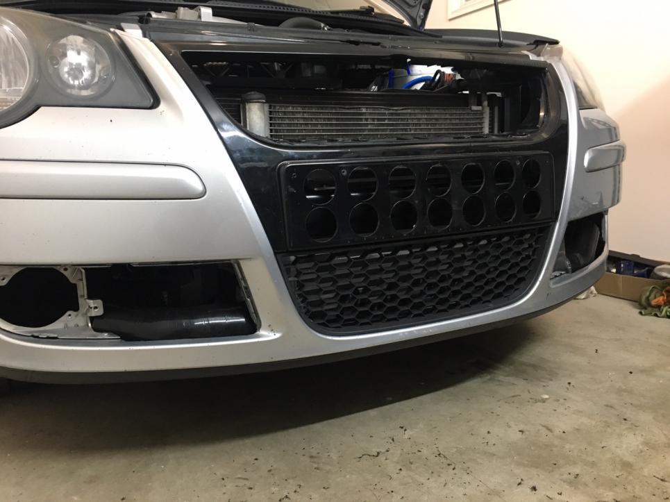

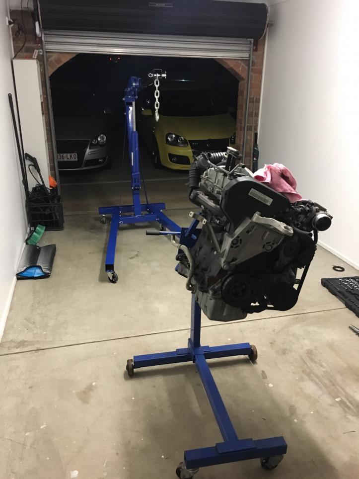

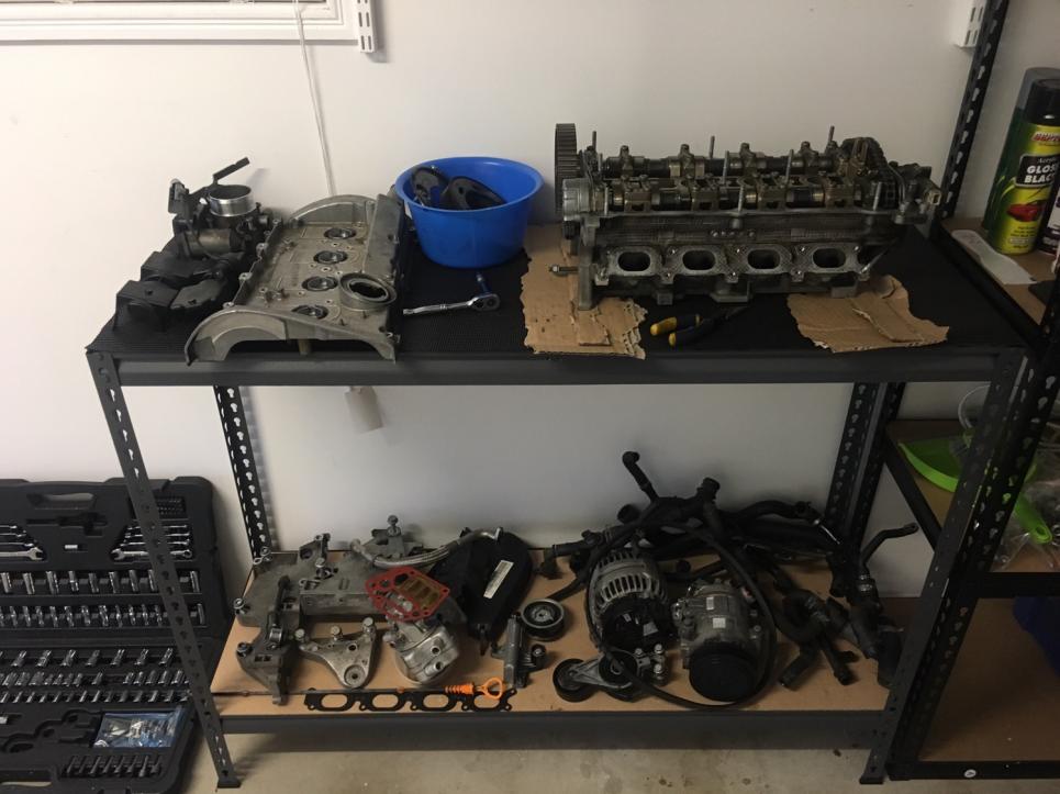

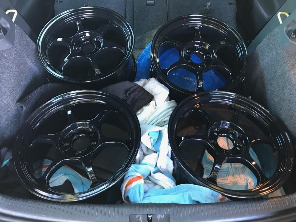

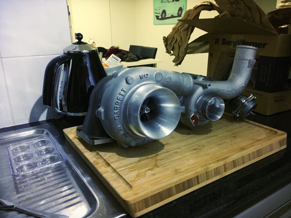

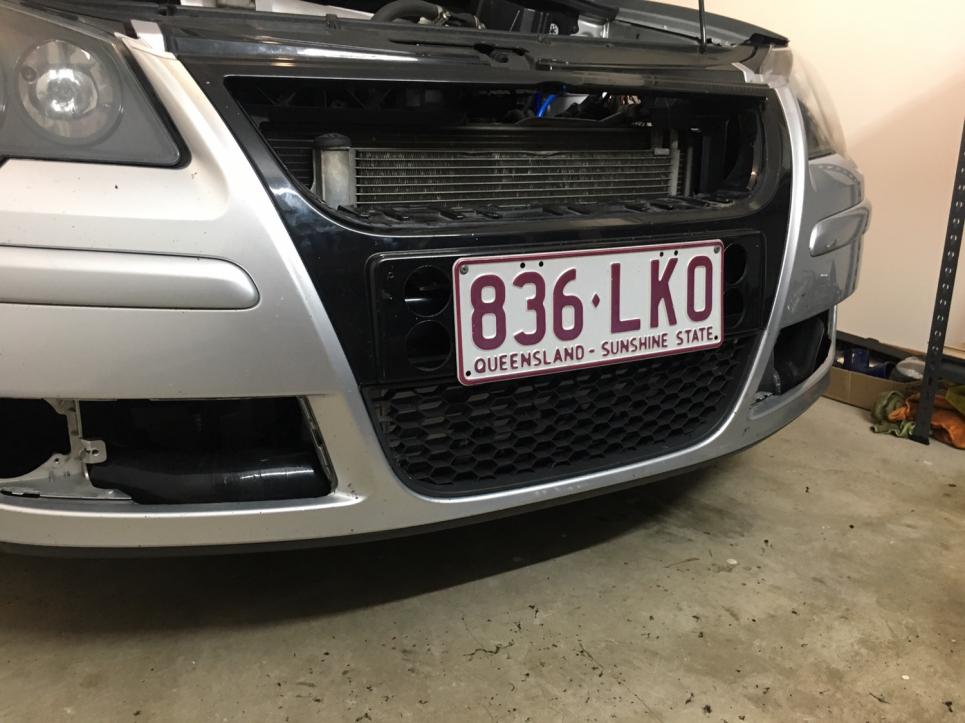

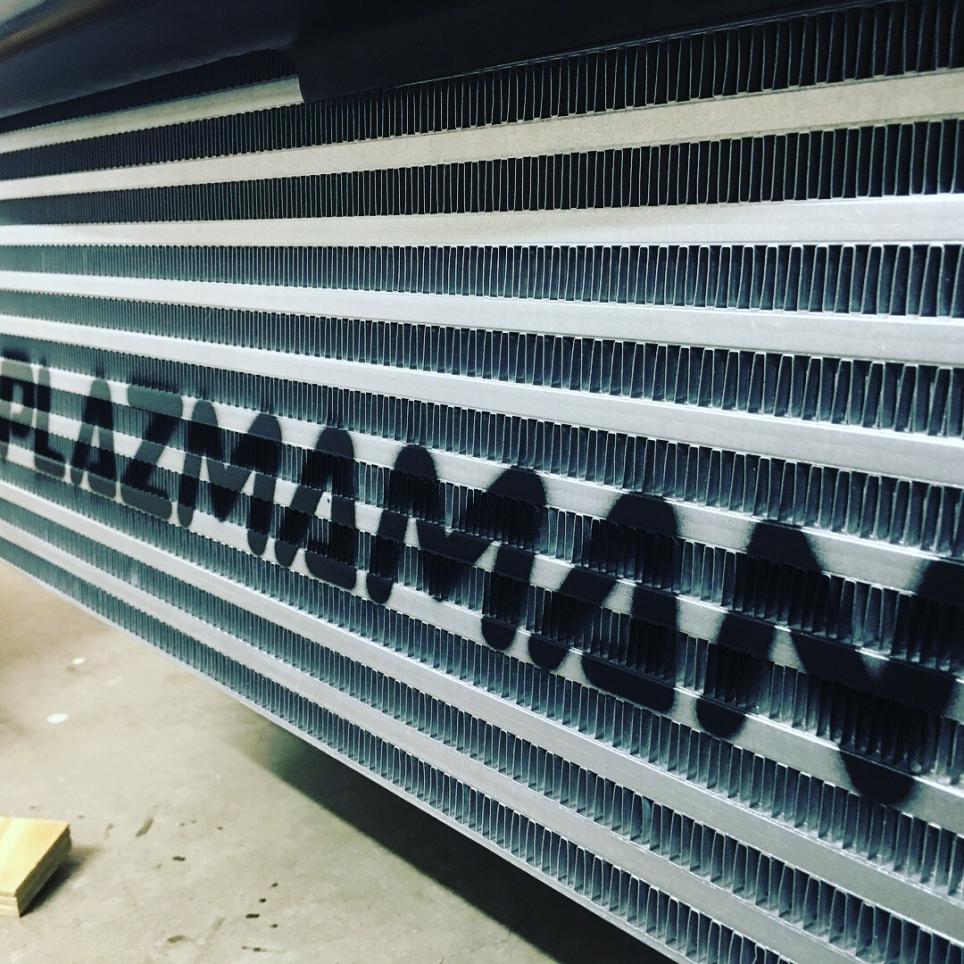

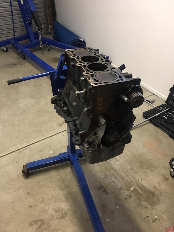

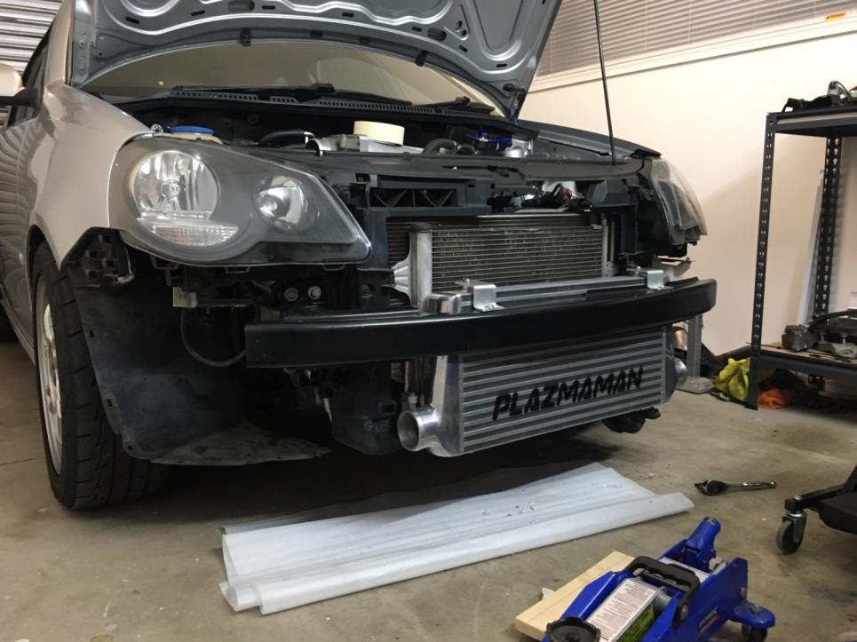

          Here's an update for those interested. Not much to say, just been spending time stripping down the new engine, mounting the new FMIC and adjusting the bumper to suit it in prep for the new pipe work to come. Had the Advans sandblasted then powder coated, with tyres being put on this week. A heap of parts arrived, with more in the way.
          The side by side comparison is next to a TTE280.
          Here's some pics I've taken along the way.

            • good to see things coming along. Glad you were the guinea pig on the bumper holes - I've been meaning to do that for a while if only hidden under the number plate though. Did you trim the lips off the crash bar underneath/behind the holes to let more air over the bumper and onto the IC/radiator, or did you need to do that for IC fitment?
              So are you staying 1780cc and stock compression ratio or doing an over bore?
              Love the kitchen pic - probably would make a good blender!
              • Louis19's Build Thread
                Thanks Sam. The trimming of the crash bar was for fitment, but a bonus for flow. The IC is bloody snug in there.
                I'll be staying 1780cc. Don't feel the need to go bigger, especially with what others have achieved with a 1.8 around the world.
                The last lot of bolts needed for the engine build are on the way so I'm not far off having that sent to the builders. Exhaust manifold is on its way, tyres should arrive today or tomorrow. Checking things off the list slowly

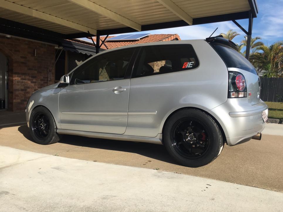

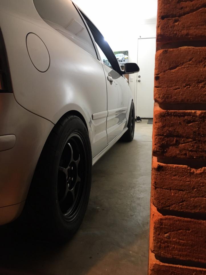

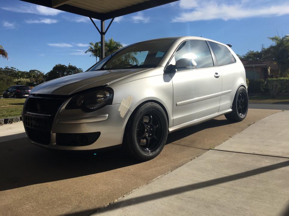

                          Tyres arrived this week, so got them fitted and bolted on. They're rather beefy, and I'm pretty stoked with how they look.
                          2006 GTI Polo - Big Turbo Build - Louis19's Build Thread
                          • Unreal - it looks pretty purposeful now. You're really filling those guards aren't you!
                              Cheers Sam, they don't get much more filled than that - in fact they are slightly overflowing

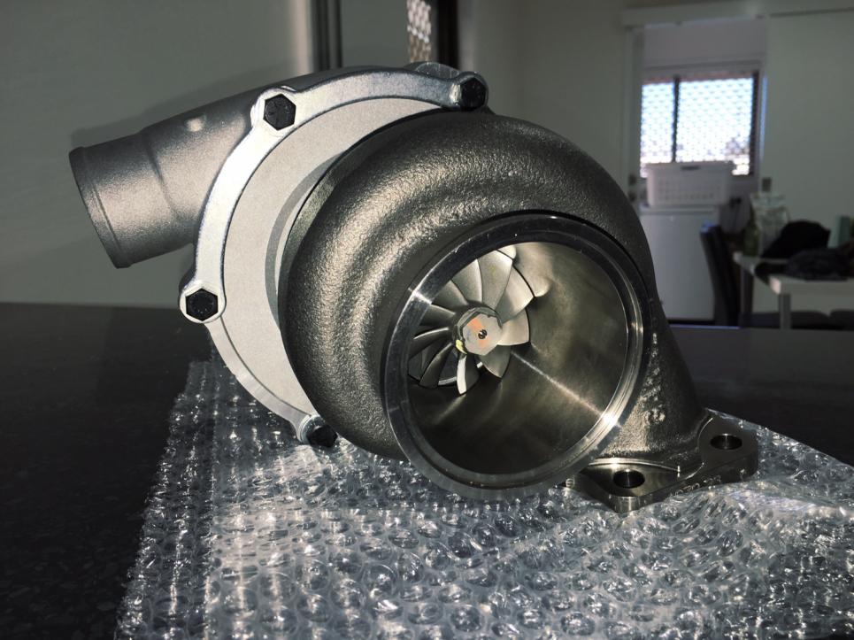

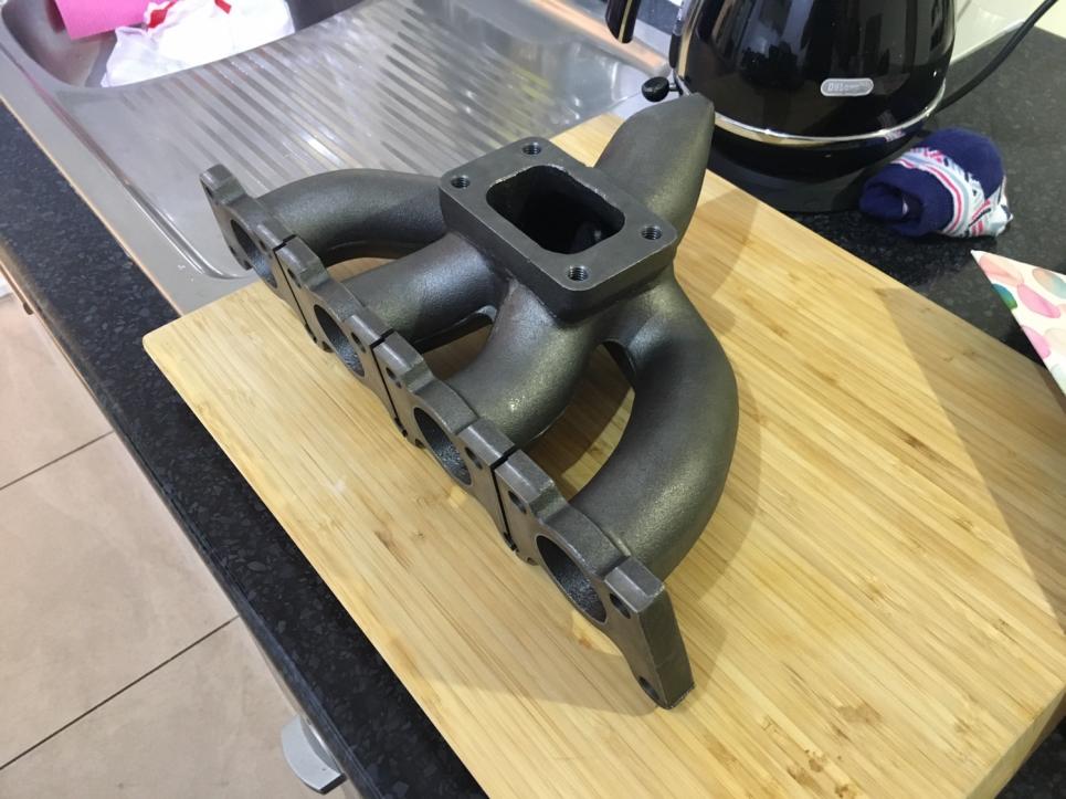

                              • Few more bits arrived. Exhaust manifold, gaskets, oil pump etc. Going and seeing a engine builder on Friday regarding the bottom end work. Also sourced a large port head AEB head that will be getting all the internals of my 70k kms engine put into it as well as a quick tidy up before it gets bolted all together.
                                I also went and got some bits and pieces to relocate the battery to the boot to free up some space in the engine bay for the new pipe work and intake off the turbo. Slowly but surely chipping away at the list of things to do!
