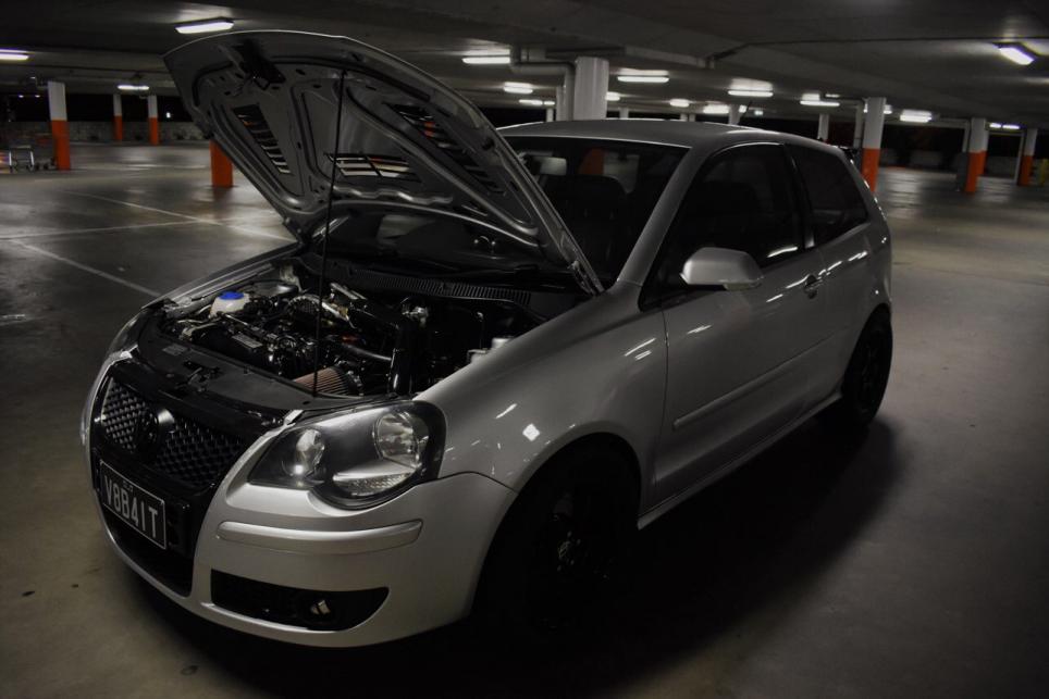

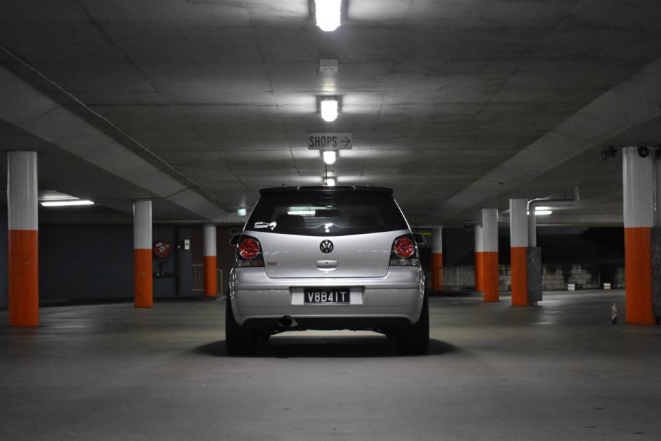

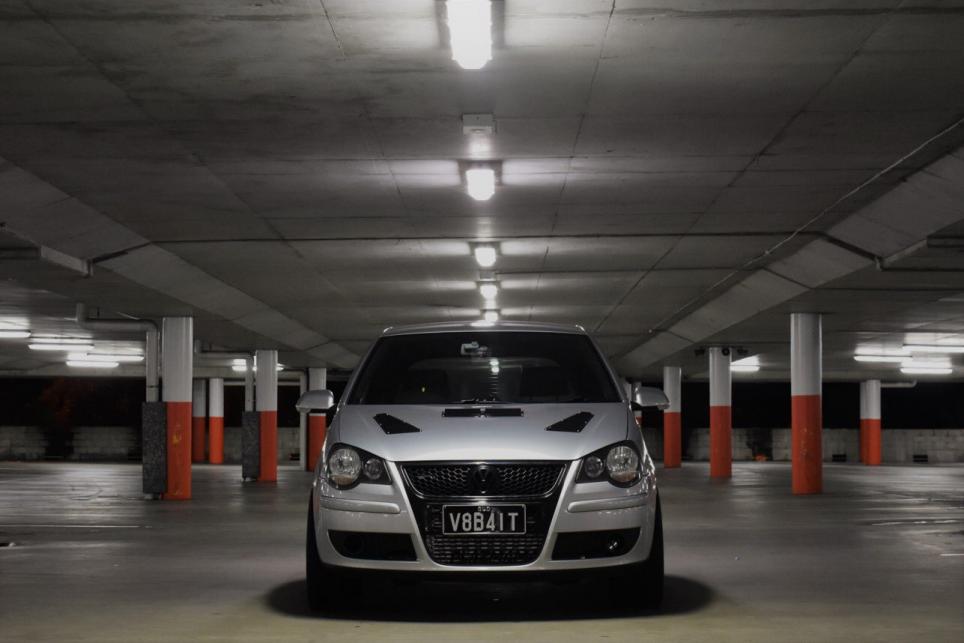

    Hey All,
    I've decided to start my own build thread to have all the stuff I've done/doing in one thread rather then having it spread amongst various others. The Polo was bought in December 2014 off an older gentlemen who used it to commute to Brisbane and back a couple days a week for work. The car was completely stock other than 17” wheels he had put on it.
    Since then, the car has become the complete opposite of stock, more so than I would’ve ever antisipated when first purchasing the car.
    As it stands, the
    current mods list is:
    ECU and Tune:
    - Link G4+ Stand-alone ECU
    - Custom tune by Next Up Performance Brisbane - 273fwkw/366whp
    ENGINE:
    - Engine rebuild Sep 2017 (Honed, new piston rings, rods installed, new seals, bearings, head cold bathed, new guides etc)
    - Calico Race bearings
    - AJL Large port head
    - Garret GT3071R .63/T3 Rear
    - Turbosmart external wastegate (10psi)
    - Bartek Top Mount exhaust manifold
    - Supertech exhaust valves
    - IE Forged Rods
    - Bosch EV14 1000cc
    - Custom Mafless 4” Intake
    - MAC 3 Port Boost controller
    - Plazmaman Intercooler 600x300x76 - Custom 2.5" Pipe work
    - 034Motorsport Large Port Intake Manifold
    - 034Motorsport Intake manifold spacer
    - Audi R8 Coilpacks
    - 3" Turboback Exhuast
    - Walbro 460 Fuel Pump
    - Forge 007 DV
    - Vibratechnics Side Engine Mounts
    - Powerflex Lower Engine Mount (Black)
    - Aeroflow 10 Row Oil Cooler
    - Mocal Sandwich Plate 80c Thermostat
    - Porsche Oil & Coolant Caps
    - 42DD Solid Shifter Cable Bushes
    - 42DD Solid Shifter Bracket Bushes
    - Diesel Geek Bush Slop Removal Kit
    - Battery Relocated to Boot
    - SAI Delete
    - N249 Delete
    - Aircon compressor, lines and core deleted
    SUSPENSION:
    - H&R Monotube Coilovers (Replaced August 2016)
    - SuperPro Anti Lift LCA Rear bushes
    - Powerflex Black LCA Front bushes
    - Whiteline Adjustable Rear Sway Bar
    - Front Solid Traction Brace and Bars
    BRAKES:
    - 312mm Audi TT/S3 Front Calipers
    - 256mm Bora Rear Brakes (To be installed))
    WHEELS:
    - AdvanRacing Original RG 16x7.5 - Stripped and powder coated black.
    - Hankook RS3 225/50/16
    EXTERIOR/VISUAL:
    - Badgeless Front Upper Grill
    - Honeycomb Lower Front Grills
    - "Cup Edition" Spoiler
    - Colour Matched Rear Valance
    - Colour Matched Side Skirts
    - Black Tail Lights
    - Billet Rear wiper delete
    INTERIOR:
    - XAV68BT Head Unit
    - Momo Deep dish steering wheel
    - Innovate MTX-D Boost Gauge
    - Innovate MTX-L Plus AFR Gauge
    - Likewise Daytona Shifter Knob
    FLUIDS:
    - Mobil 1 (5-50w) Full Synthetic
    - Redline Lightweight Shockproof Gearbox Oil
    - Nulon DOT 4 High Temp Brake Fluid
    TIMED EVENTS:
    Willowbank 1/4 Mile: 13.1 @ 107.5MPH (04/01/2016) - K03 Hybrid Setup
    Queensland Raceway Sprints Circuit: 1:02.31 (17/9/16) - H&R Suspension 1:02.9 (02/07/2016) - MCA Suspension - K03 Hybrid Setup
