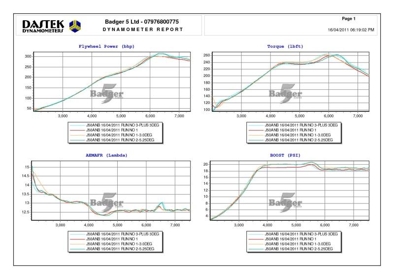

                          • Originally posted by vwthunder View Post
                            I would pay the $$ and change to GIAC or Revo, but at the moment I would like to do a bigger turbo, K04 or Frankenturbo or something, so not worth changing the tune yet
                            Don't get a K04, waste. CR Hybrid...
                            Have a look at this thread...
                            This is in a Lupo with the 1.8T:
                            Boost is only part of the equation, this thing is not doing more PSI than ours...
