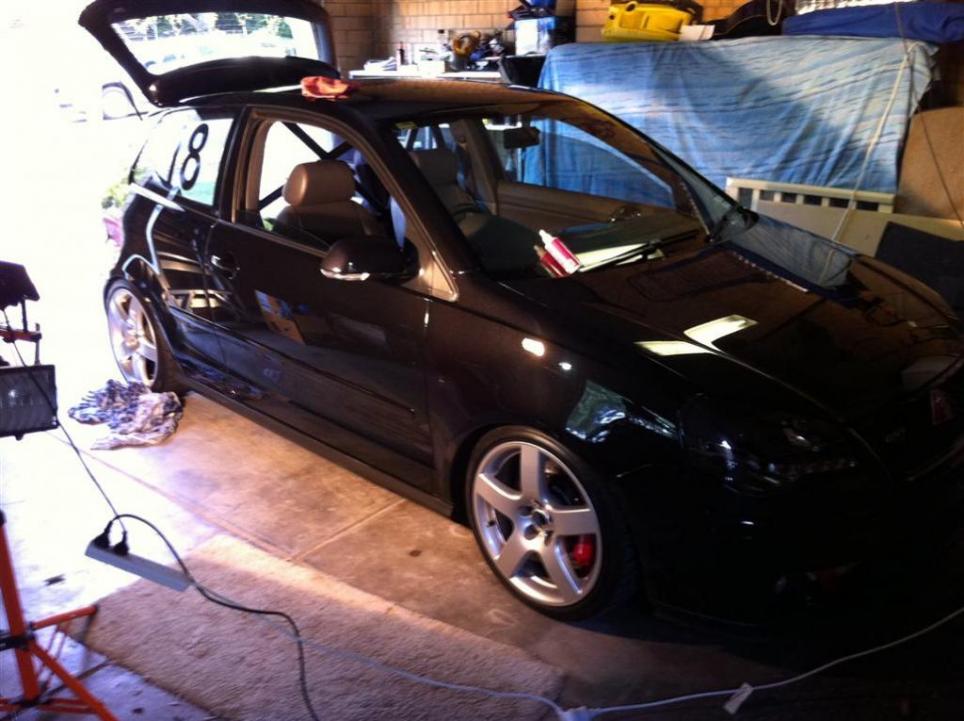

                    • Been spending lots of time getting the car ready for ILV
                      Seeing as i won the show last year I have to go back bigger and better
                      Spent 12-13 hours over 2 days detailing
                      Washed, Claybared, Menzerna FG500 on Surbuf pad, PF2500 on Festool white pad, SF4000 on black pad then sealed with Wolfs Body Wrap and P21S 100% Carnauba wax
                      Sorry for the Iphone pic, will get some better pics later.
                      Still not 100% happy, but it will do for now

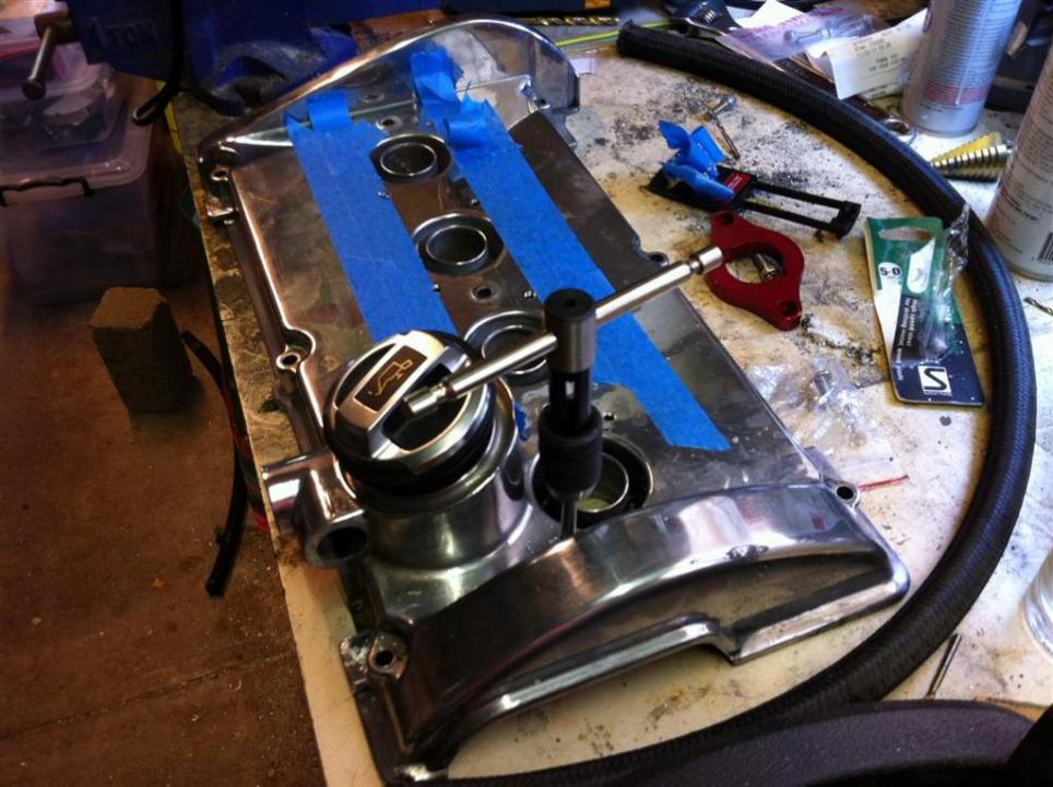

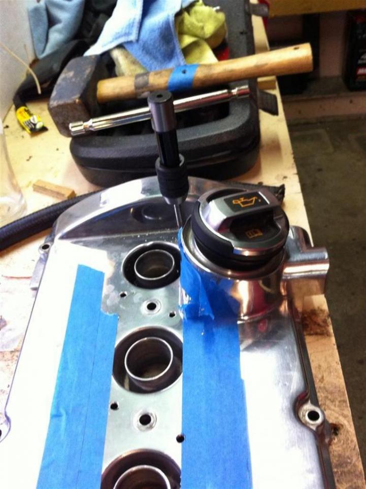

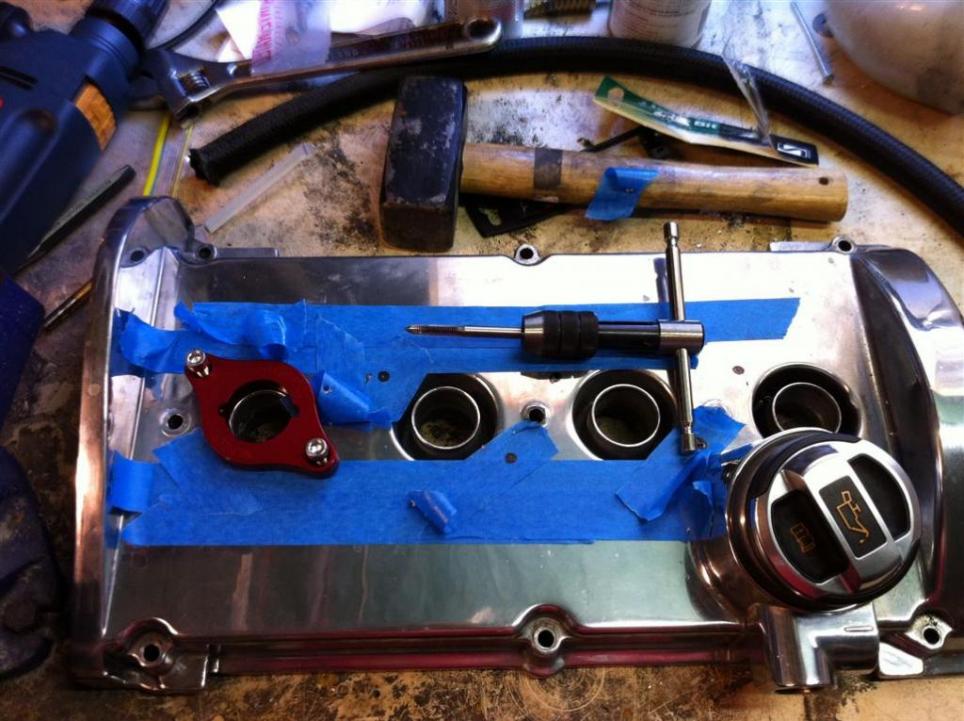

                      • Smooth Valve Cover, well no way to mount coil pack adapters
                        So had to drill and tap holes
