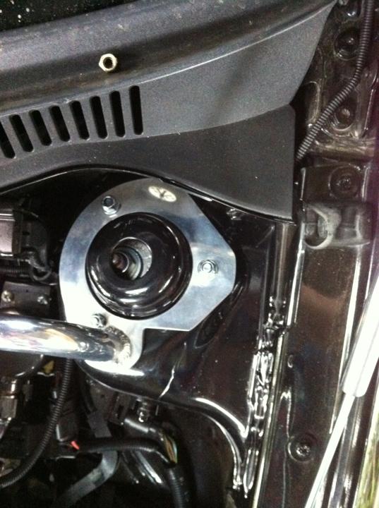

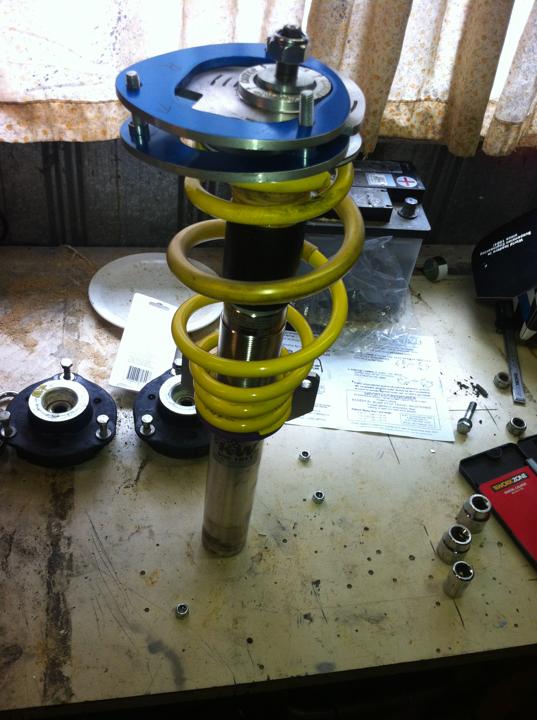

  • Got my Kmac, camber/caster strut tops a few weeks ago, but didnt have time to put them in untill the other day.
    Anthony was the guinea pig I guess as he was the first to work out that there were problems with them. They went back and forth to Kmac for a few weeks till they were finally right
    Cant even get a allen key in to adjust the shocks, they are over so far. Thinking about cutting the tops off

      First impressions, wow and wow, its not even alligned yet and it feels like a totally different car, feels like a proper car now, it was missing something. It now feels like it is on rails. All of the clunking and banging is gone, guessing the standard ones were shagged but suprised they sent so much vibration through the car, so the car is actually a lot smoother with the soild mounts in.

      • So the knocking noise my wife can hear on the front left forward of the dash, could be the strut top bearing bush?
        I know I can hear them clunk over my driveway crossover. Query re hats.. are they dome shaped to strenghten that section? Cuttiing them off might not be a good idea? Cheers Al
        PS anyone got a good pair of Strut tops they do not need any longer? Maybe someone has the complete GTi suspension struts tops and rears as well wanting a home?
        Pm me please.
        • Originally posted by Polo GTEye N9 View Post
          So the knocking noise my wife can hear on the front left forward of the dash, could be the strut top bearing bush? .
          Could be, or lower control arm bushes
          Think most of the Polos with serious track mods have had them cut, I know Van (ssman) cut his, pretty sure Eddy's are too

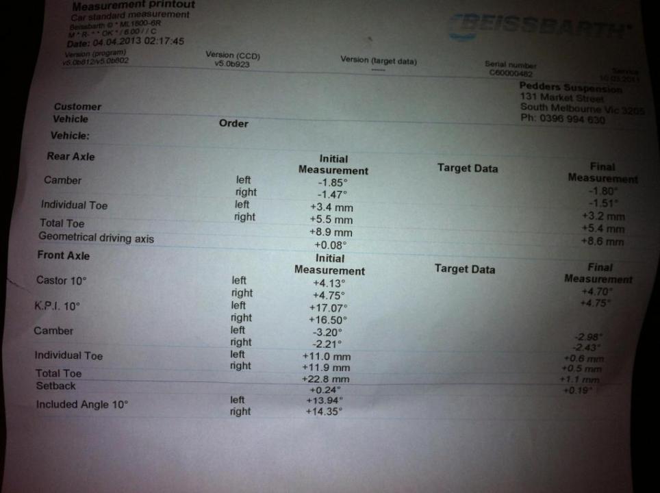

          • Had her in a Pedders for a allignment, they said it was quite time consuming as you have to set it, check it and do the process over and over

              • Hoyhoy.
                Troy when going for heaps of negative camber for street use , ya might find the steering different, usually for the worst.
                Google = scrub radius, for some reasons.
                Hooroo.
                • Originally posted by Eddy View Post
                  Hoyhoy.
                  Oh and eddy, I have 3 degrees with semi standard size springs
                  MODS- TOO MANY

                    • That's an awful lot of camber for the street
                      • Originally posted by Stuwey View Post
                        Yeah got a track day coming up, so they suggested i leave it like that, besides it is not really a daily, seeing as i walk to work
                        MODS- TOO MANY
                        • That's some serious camber mate how do you find straight line freeway driving sitting on 100kph?
                          • Is not too bad, I drove on the freeway the other night in the rain and i was hanging on to the steering wheel very tightly.
                            Only really seems to pull when the road is flat.
                            Cant adjust the compression on the front as it is over too far, hiding under the strut dome
                            Feels like a go cart with the KW's set just over half way, turn in is sensational. Definately one of the best mods for $400
