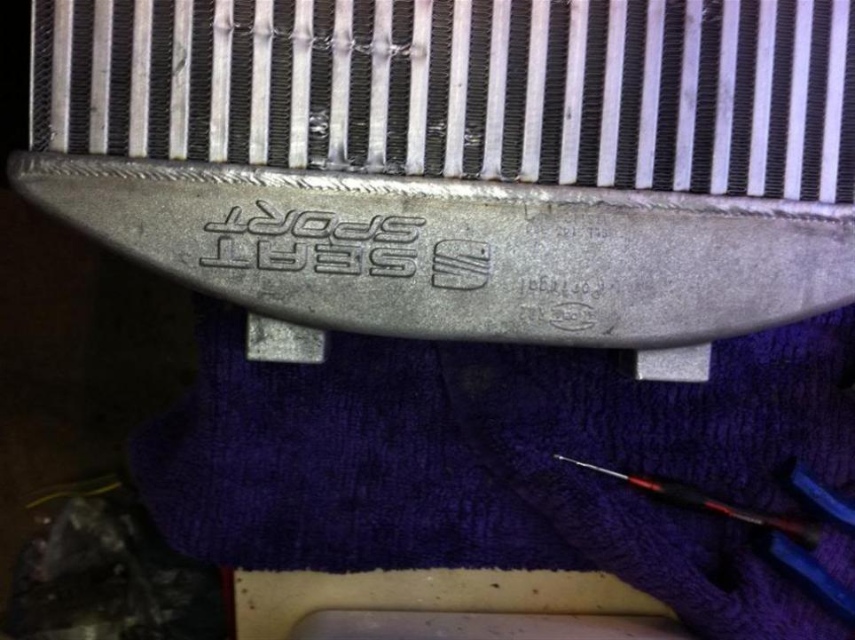

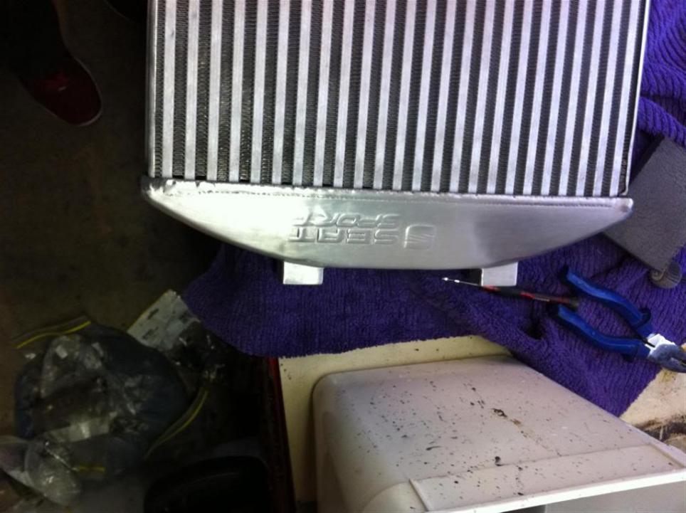

        • Started sanding down the intercooler
          Before
          After
          Still have a long way to go, only did a 80, 120, 160, 240(wet), 360(wet) sand
          Oh and Doh, yes the intercooler has some marks from shipping, looks like they sat something on it , should be ok tho, its on the back

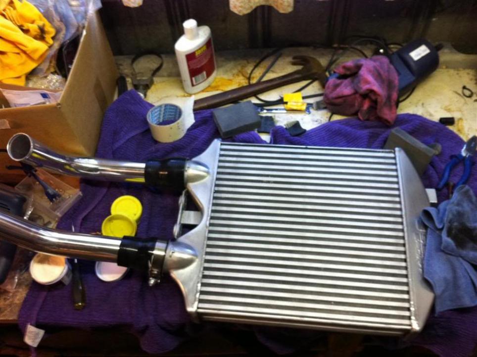

          • Mate, whats the dimensions..looks a fair size
            Polo 9n3 GTI
            • Looks big in the pics, but it isnt really, suprised how small it is. I will measure it tomorrow
              You can see the hammer in the pic, the hammer is 3/4 the length of it

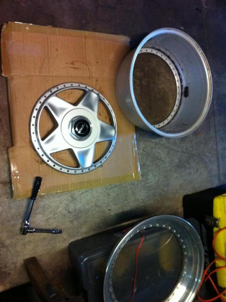

                • Started puling them apart, well only got 1 apart. It is painfull with 38 lock tighted bolts each wheel
                  Dont know what to do with them yet, didn't really want to spend too much on them, maybe just a polish and new bolts ?

                  • Originally posted by vwthunder View Post
                    Are you going to run those metal connection pipes to your turbo and inlet manifold? The seem a fair bit smaller than the inlet/outlet of the intercooler itself, looking at the way the silicone connectors narrow down.
                    Resident grumpy old fart
                    • Its 2inch, which is the same as the piping on there now and the same as the Forge piping for the Seat cooler. Going into the turbo it is only 2inch i think

                              Test fitted my Seat cooler
                              I see what you mean, it looks tiny - dunno why you're bothering really
                              Wanna sell it to me a some beer money

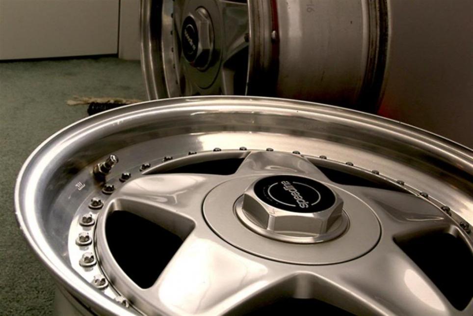

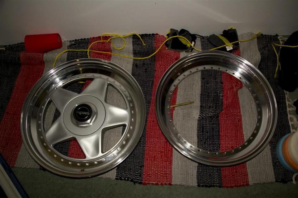

                              • 2 lips polished. Took a lot of time to get them like this. Wasn't easy to get the clear coat off.
                                Sanded the rough spots at 360, then the whole thing at 600, 800, 1200, 1500, 2000 polished with 2 different mods on the drill with different compounds, followed by some mothers mag wheel polish.
                                Not 100%, I had some dont professionally last time and it was amazing, I would say these are 90%. I would say i spend 6 hours on each of them.
