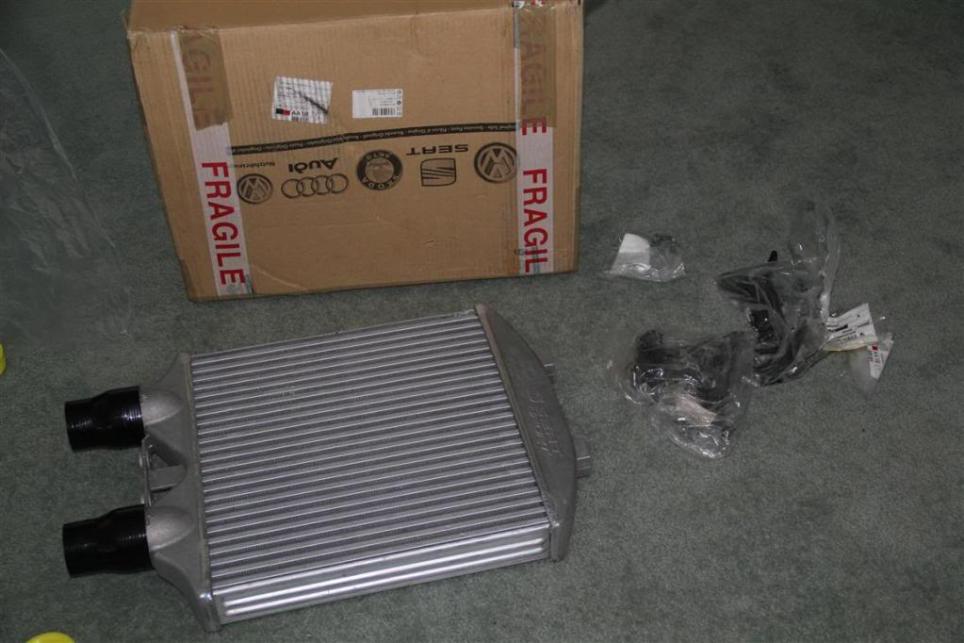

                Look what arrived today
                Looks a lot smaller in real, thought it would be bigger

                      Still waiting on all the hoses, bends etc to arrive
                      Thye forge piping is around $400+ landed. My piping cost me around $200
                      MODS- TOO MANY
                      • #86
                        Great, I will follow with interest, as I will need to install the same at some time.....
                        Where did you get the cooler from (URL), and what pipes are you using; I was just going to get the STD forge ones.
                        Are you going to fit thisyourself or do you have anyone that will be assisting...I only ask, cause i will def need assistance.
                        Anyway, this is exciting...enjoy.
                          You have to do your research !!!
                          Cooler was from Ebay UK, just found someone selling one, they bought it and changed their mind. What pipes am i using, well i am buying some bends and silicon hoses and clamps and making it fit, basically i just copied the forge piping kit from a pic, not hard to do.
                          I will fit it myself
                          From a Seat Forum
                          The kit comprises of
                          2x S60 – 51 straight reducer
                          1 x C 51 straight coupler
                          1 x A 45-51 45 degree bend x 51 dia
                          1 x 51 cut straight length x 335 mm long
                          1 x A45-51 alloy tube
                          1 x A90 -51 alloy tube
                          1 x A90 – 51 alloy tube with map sensor
                          All hose clamps
                          Map sensor screws
                          Plus cnc machines alloy couplers

                              The seat cooler has brackets to mount it to the Rebar
                              All you have to do is connect some hoses
                              Clicht, do you know Jmac sells the seat cooler and piping kit

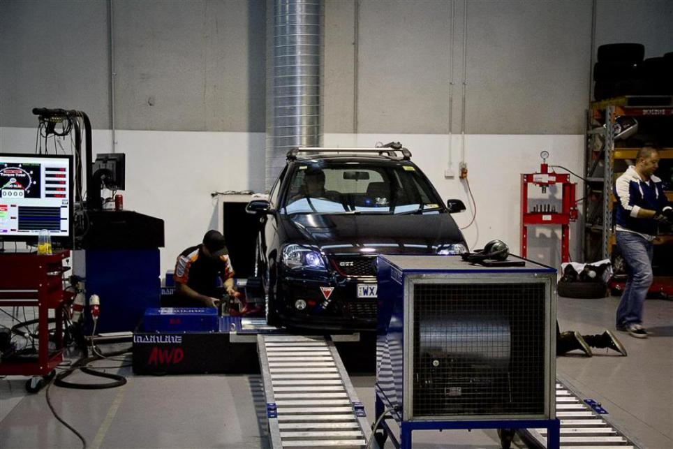

                                Oh here is my dyno graph
                                Check out my power curve 1.8T + K04 = ultimate curve for polo
