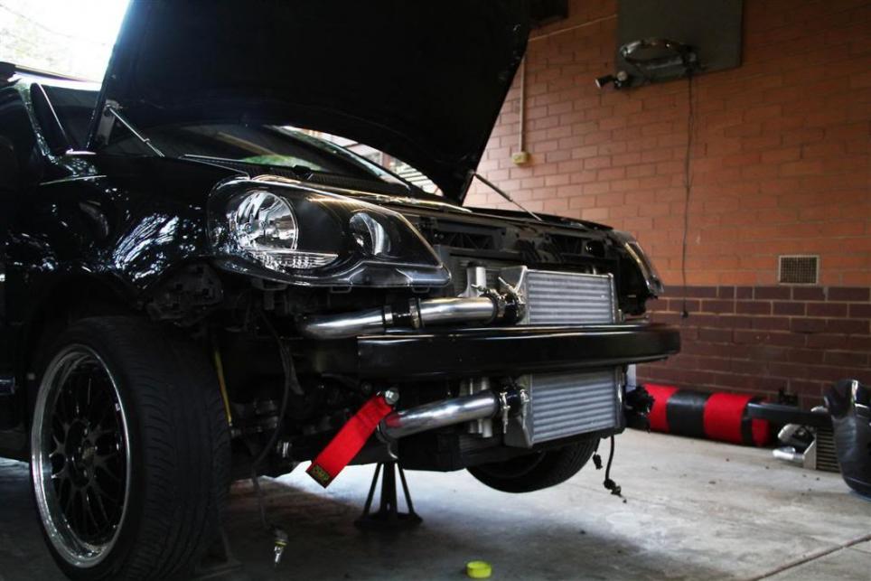

  • All the piping i purcased for the Seat Sport Intercooler
    One of the Seat sites listed all of the parts in the Forge kit (oh it only comes in Blue)

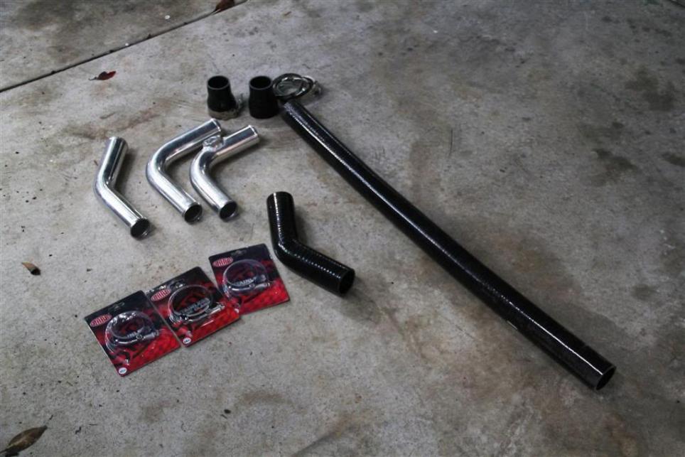

    So the Forge kit consists of this -
    2x S60 – 51 straight reducer
    1 x C 51 straight coupler
    1 x A 45-51 45 degree bend x 51 dia
    1 x 51 cut straight length x 335 mm long
    1 x A45-51 alloy tube
    1 x A90 -51 alloy tube
    1 x A90 – 51 alloy tube with map sensor
    All hose clamps
    Map sensor screws
    Plus cnc machines alloy couplers
    My Kit

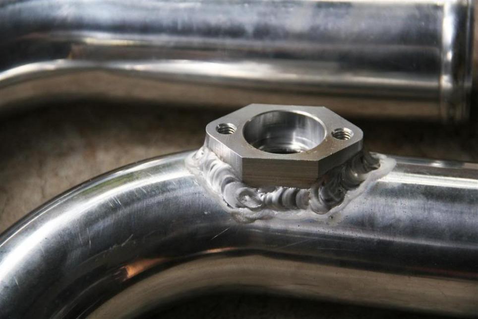

    • Went to about 5 different places to try to get the Map sensor bung welded into the piping, seems no one can or wants to weld aluminium (hint to anyone else who wants to do it themselves)
      Found a place and they did it for $30
