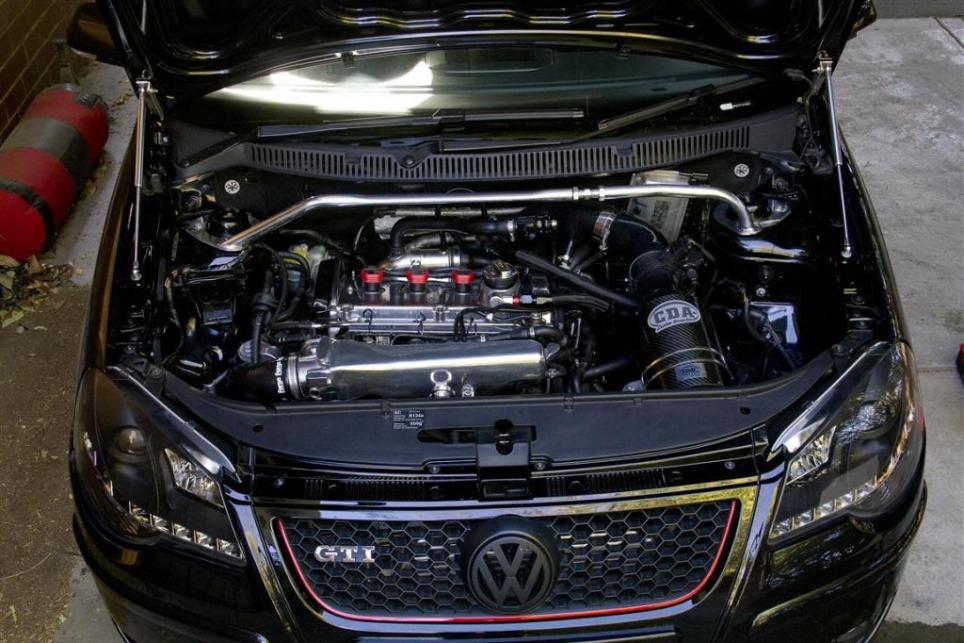

  • Got the inline filler neck and cap in with a bit of effort and some modding
    Shame there is a big bracket welded where the bottle sat. Guess i will have to pull the engine out and smooth the bay

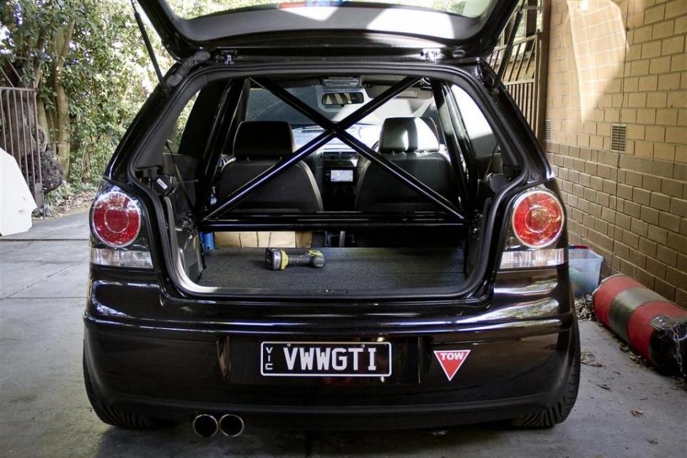

      • Spent 2 days making up the false floor and trimming it
        This is the final result
        A little hard to see it all in the pic, will try to get some better ones

          • Is it still registered as a 5-seater? Are you gonna sort a trim for the wheel tubs etc?
            • Originally posted by Stuwey View Post
              Wheel tubs are going to have the factory moulded carpet in there, just haven't put it back yet.
              Still registered as a 5 seater, might change it soon, or just wait till i get pulled over and told off lol, then change it

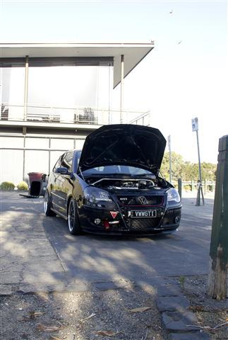

              • Few new pics, as it was clean the other day from a JDM meet i went to. Oh it was more popular there than most of the other rides, Evo's STI's etc

                      • Hey seems I have now found out who Troy is and I've said it once and will say it again your car and the mods you have done are awesome. I'm currently in the process of moving the wiring to to the wings to help smooth the bay and wanted to do this mod to. Have you had any issues? Air locks? Over heating? What pressure cap did you buy?
                        Do you have a link to the parts if they were from eBay?
                        Thanks

                          Glad you had time to read some of my thread Oh i have some Recaros out of a Cilo coming from the UK
                          Actualy i have been having problems with the setup. I read somewhere to get a 16psi cap, it seems to not hold enough pressure, when the car gets hot, even after i turn it off, it seems to open and dump water. I have ordered a 18-21 psi cap which i am waiting for, hopefully it solves the problem, I will let you know how i go
                          search, inline filler neck, inline filler, radiator filler etc
                          There are a few floating around
                          New Speedway Inline Die Cast Aluminum Radiator Filler/Fill Neck, 1-1/2" Hose | eBay
                          Summit Radiator Hose Filler Inline Aluminum Black 1 5" 1 5" ea 2202 11 | eBay
                          Summit Radiator Hose Filler Inline Aluminum Natural 1 5" 1 5" ea 2202 | eBay
                          New Speedway Inline Die Cast Aluminum Radiator Filler Fill Neck 1 1 2" Hose | eBay
                          STANT 18-22PSI MOTORSPORT HIGH PRESSURE RADIATOR HEADER TANK CAP TJ | eBay
