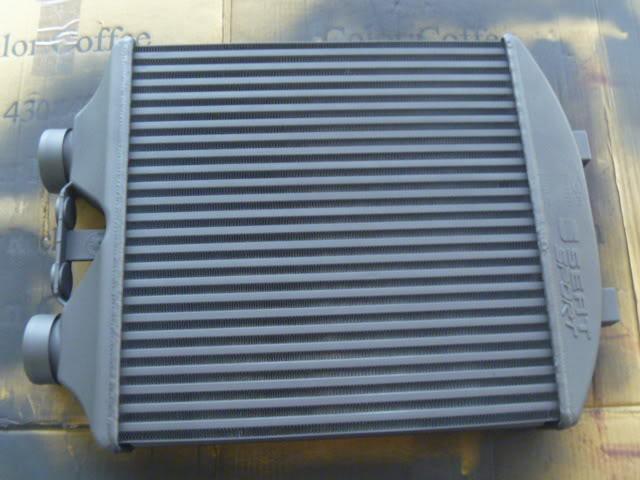

                    • New bits
                      Thanks Jmac!!!
                      Stealth look

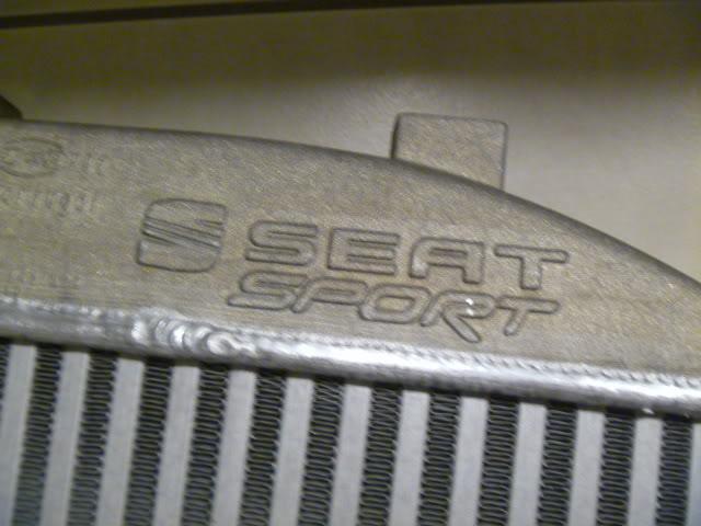

                      • Awww yeah, the seat sport intercooler!
                        Can't wait to have someone in Aus rocking this thing.
                        Our forum friends from overseas have always said good things about it.
                        Is that also a lightened flywheel i spot?
                        Can't wait to see this thing out at Happy Laps again soon.

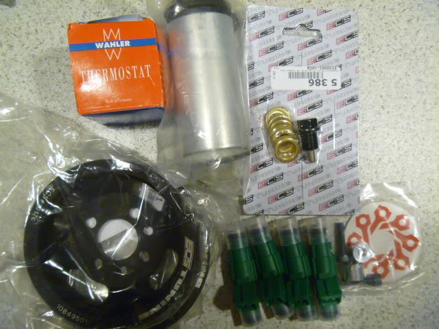

                        • Lol and rock it I will! Yep light weigh pulley set at Jimmy's recommendation. I have been doing some research and the pulleys matched with a light weight flywheel have had decent power increases recorded with the 1.8t.
                          Need some new rear tyres for happy laps though
                          • I'm using Wahle 80deg thermostat too....you won't go wrong with it

                              I have a clutch kit that has been sitting here for 8 months lol. I wonder how it feels with the 14lb flywheel and the lightened pullys. So it should have a power increase ?
                                From what I've read 5 - 10whp or so! Stop being lazy Troy
