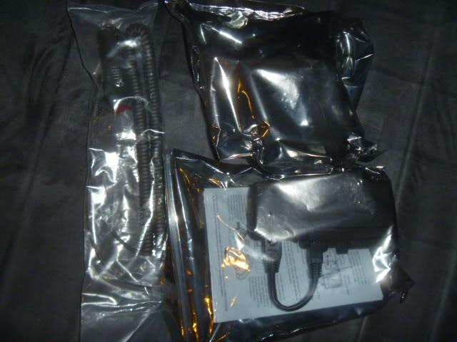

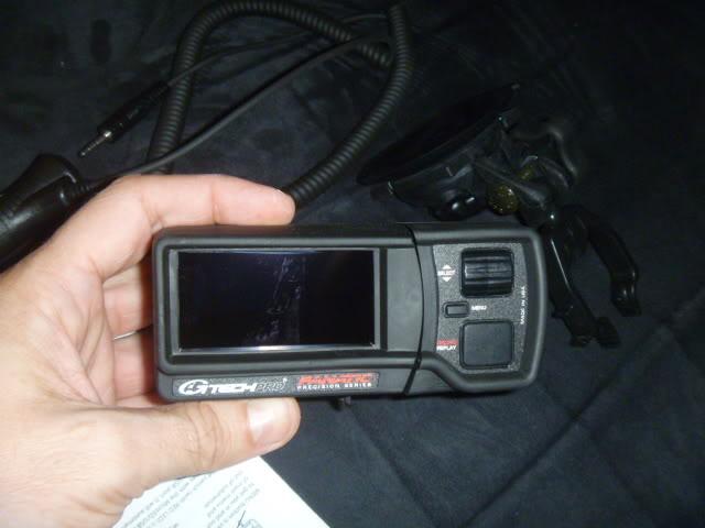

    Well my amazing partner Natalie got me a sweet as Christmas present. She totally gets my little addiction Can't wait to get some power figure comarisons when the new intake arrives. It can connect to up to 12 satellites at one time for super accurate logging.

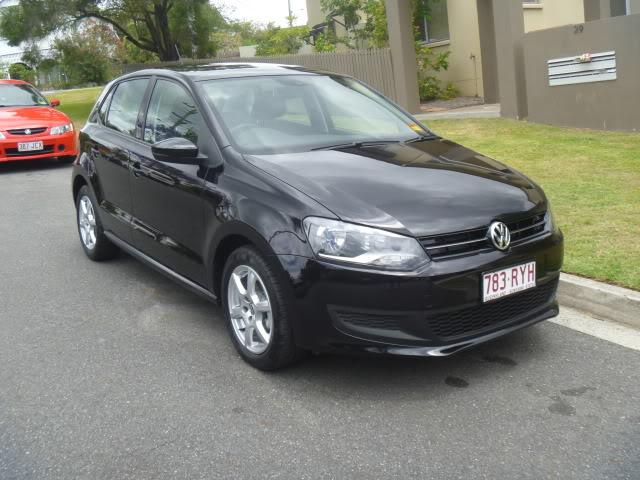

    Couldn't help myself, here are Nat's presents for her new 77TSI. The HR's are some serious drop 35/55mm
    And introducing her new pride and joy

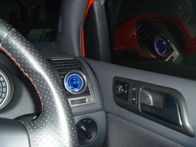

                    • Originally posted by VWindahouse View Post

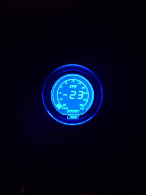

                      Update!

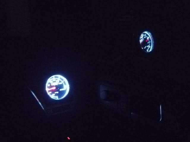

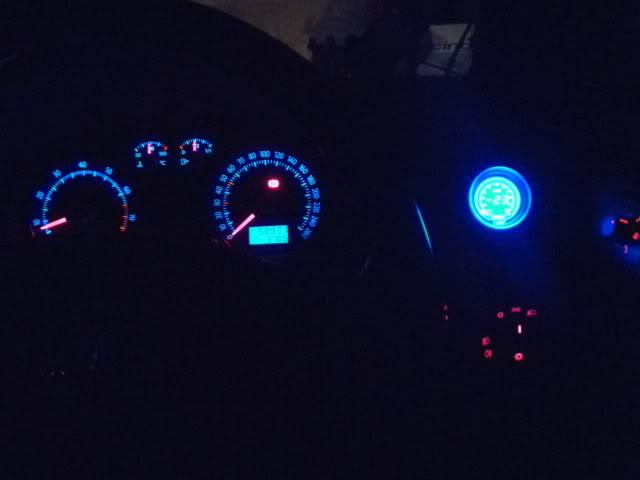

                      New boost gauge arrived. Think I mentioned earlier that the metal senders in the engine bay keep on frying because of the heat so I ditched them just for the boost gauge as it has a plastic sender that was mounted on the right hand side of the ECU cover and away from the nasty heat. This meant filling the space above the singe din head unit where the three old gauges were with a singe din VW pocket and moving to the air vent pod set up for the boost gauge
                      Only problem was at night the gauge was totally distracting because it reflected so brightly in the side mirror and was a little dangerous when going to change lanes as you couldn't see squat.
                      So went with a darker blue gauge that matches the taco and it's dimmable too. Looks really good in the flesh and on boost the analogue sweep screams around the outside and it also has the digital readout in the middle!

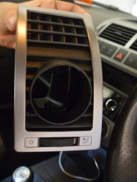

                      Hey Sorry old pictures but as i was looking through and drooling about all your mod,
                      i was quite intrigued with this gauge holder, really neat!
                      Does it still work as a normal airvent aswell??
                      Dont Want to boil in summer days=)
                      cheers matty
                      GIAC | FORGE | D2 | TURBOSMART | K&N | XFORCE |
                      • Sounds like a plan, thanks for your help again Sean! Can't wait to have another crack.
                        Matty unfortunatley you do lose the use of the vent all together. But a couple of well places drilled holes at least gets some cold air through

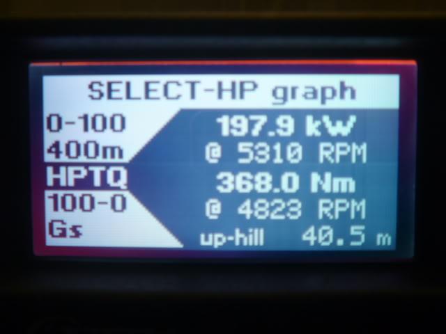

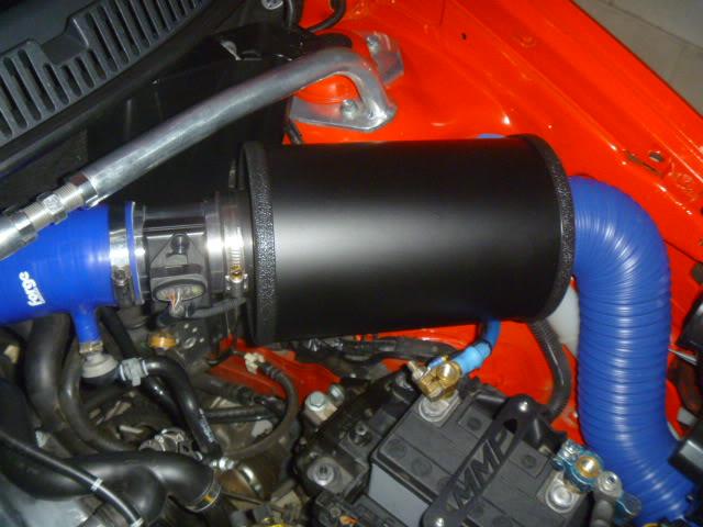

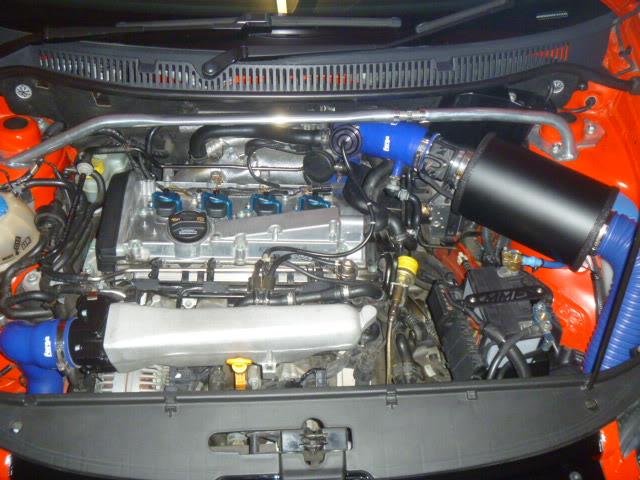

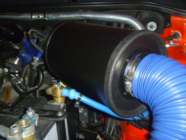

                        Well the intake arrived and all I can say is FAAAAAARRKK YES! Really well built and looks the bomb. The step down MAF housing is a piece of machining art. And the 4 bar reg is totally doing its job as the ECU has not bleed any boost at all due to the 3" MAF like last time.
                        And Steves theroy regarding the extra air volume and therefore more ponnies due to the larger size MAF housing is spot on. Also helps feeding in only ram cold air too I guess. Check this out

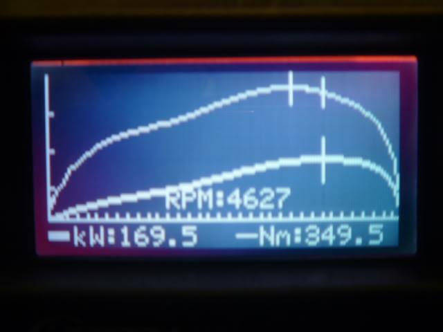

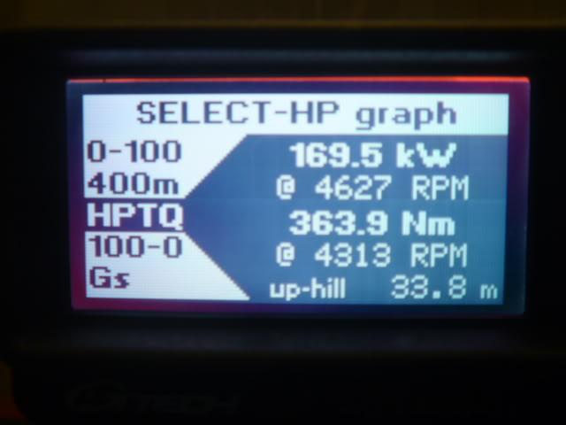

                        G-Tech run with exposed pod filter and 2.75" MAF, 3 bar reg @ 28 degrees outside temp

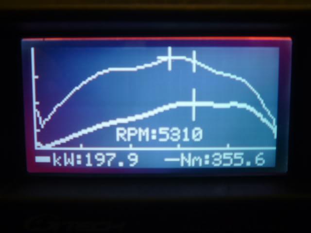

                        Run with new intake 3" MAF, 4 bar reg and 26 degrees outside temp
                        Both runs on the same bit of road in second gear for obvious reasons and slightly up hill.

                        • Good to see the hybrid is doing what it was intended to. Making me envious (and now I have a jobby, I might have to play a little catch up)
                          • Standard turbo still fitted, so it's not done yet by a long way!
                            • oh... I wonder how acurate those power figures are then...
                              That would have to be up there for a standard turbo and block.
                              Did the airflow have to be reprogrammed? I was under the impression those things were hard to tinker with.
                              • Wow 30KW with a enclosed filter, Maf housing and a 4bar. Hmmm, maybe you should get it on a Dyno or hit the quarter
