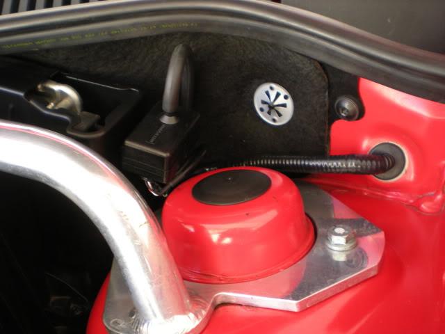

                          • These seem pretty impressive gauges. I think I'll get one (probably digital series) to replace my mechanical boost gauge.
                            Any chance of an under bonnet photo to show how you mounted the sender, and where you tapped into for the electrical feed?
                            Thanks in advance.
                            • Sorry this is the best photo I have
                              The sender is screwed onto the ECU cover and the wiring feed through the fire wall.
