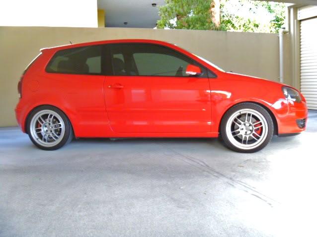

Anyway some very bad shots to show the drop with the coilies. If it doesn't settle a little lower soon I will drop it some more
Before
After

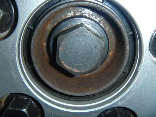

Also stock driveshaft bolt

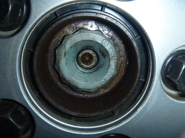

Audi bolt

Thats a different joint too though, the polo Gti joint has the threaded piece external as shown and the Audi one there is from way back with the internal threads, i agree a much better attachment. The threaded nut on the Polo is a shocker with a external pin threaded on the joint especially as you go up on the torque as this little animal is. I have in the past mentioned the joints and shafts are weak links when the power and torque gets raised but its only sense that eventually the gearbox is the weak link. This has got to be factored in when the mods get larger and the power and torque gets bigger but im sure most know that, im summarising really guys, as you would be surprised, you only have to read about " how much torque will my DSG stand??? Manuals are rated too naturally.
