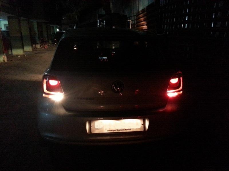

Hey them LED lights look great. Iv got the black tinted ones but not LED wish I waited now :-/
I also had to take the fog light reflector out coz it was on the wrong side lol.

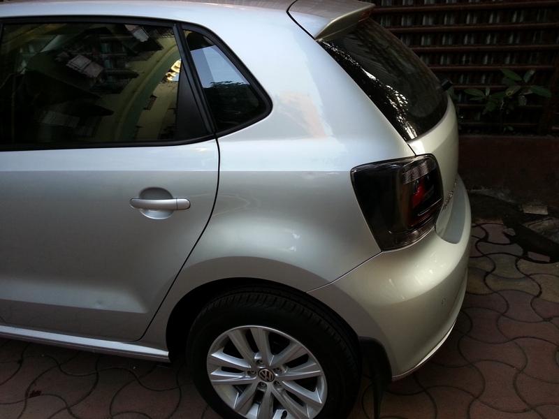

Okay, seeing as quite a few are interested in rear taillights and what options, here goes...
I've purchased the standard black tails:
So far we've established there are two ways about modding these... swapping for OEM light bulb holder, or modding wires. Nonetheless, fog cover needs to be taken out as on wrong side. OEM quality so fitment is perfect.

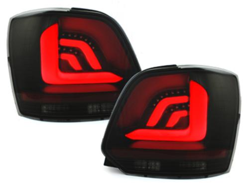

Now I've purchased these. Smoked ones, red also available.
They are produced by Eagle Eyes Taiwan. Looks awesome as it matches the OEM Bi-Xenons. Only the parkers are LED, everything else is just stock bulbs. No error as resistor is built inside unit. One thing I noticed is that the instructions indicate there is supposed to be a light panel included, but wasn't as they want us to use our factory one (maybe due to the fact these lights were made for LHD). Also need to pull out fog light lens cover. Fitment maybe about 90-95%, you can tell they aren't factory but unnoticeable close up. I'll have better pics up later.
Also purchased some Dectane "light-bar" LED rear tails. As soon as I receive them I'll post em up. LHD so will need modding too. Smoked purchased, but also available in red.
I've pretty much got all the tails that are available currently, so save yourself the trouble and just fire off any questions in this thread and I'll try to help out! People might say waste of time and money, fair enough!

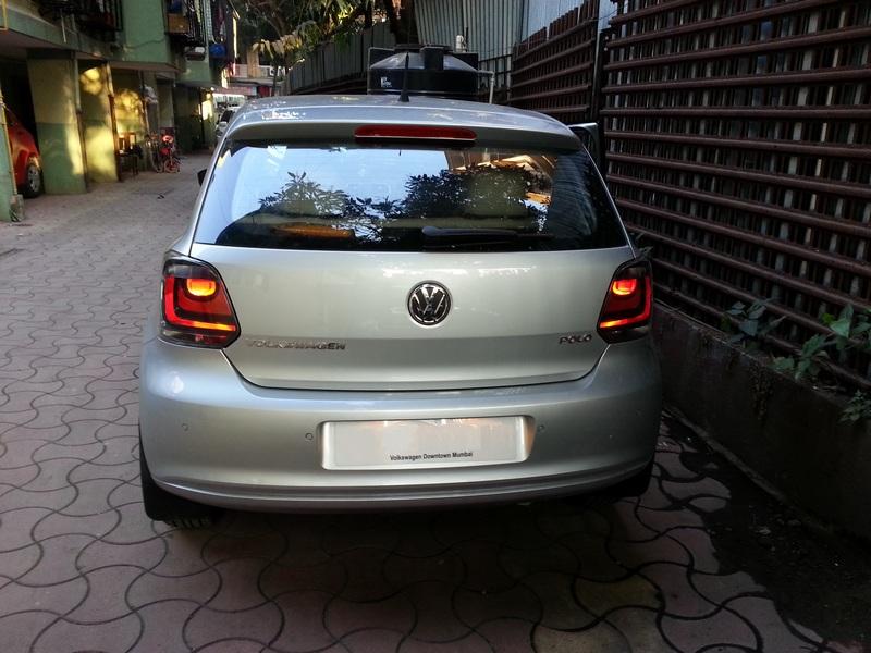

Removed the red lens reflector from fog light compartment. Then applied red gelatin paper on fog bulb. The heat of the bulb helped to fuse the red gelatin paper giving a perfect red illumination. If gelatin burns away, I will get the bulb red tinted.
