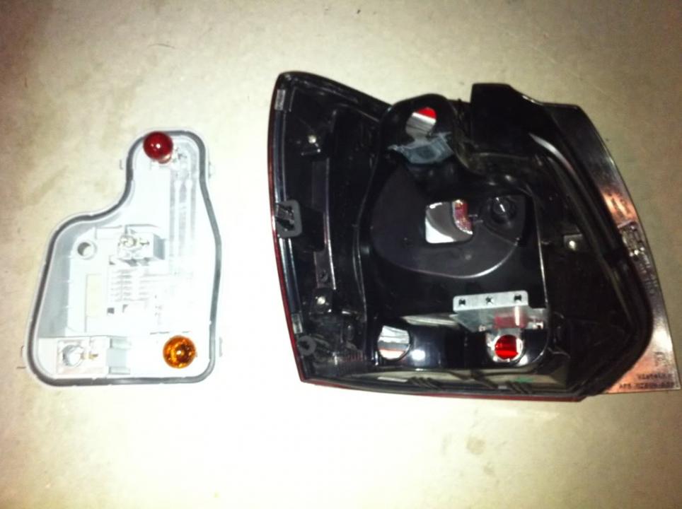

                  • Got my euro R black tails (from Kufatec) and after taking out the fog lense and installing I had no reverse so I compared the light holders. I couldn't see the difference but decided just to swap them with the old ones. So I just needed to swap the brake globes (new ones are red tint) And found the brakes globes where soldered. Has anyone else found this? There pretty easy to remove the solder but it seems a odd thing to do. What happens when the glob blows.
                    MY16 Candy white Octavia VRS Wagon, sunroof, 19" black pack, tech pack, comfort pack, auto tail gate
                    MY12.5 Polo 6R GTI
                    • Originally posted by lunchboxGTI View Post
                      Solved it. The wire comes in to the second from the bottom but the euros have it at the bottom. So I swapped the pins for now. Will get some red tint brake lights and use the original globe holders after I change the pin back.
                      Still doesn't explained why they soldered the globes in.

                              • The oem tinted dont need any rewiring. The lights are two parts. The housing which has the outer lenses and the globe holder that just clicks in the back and the globes in it and the electrical connector.
                                With the oem tinted you have to swap your original globe holders with the ones that come on the tinted. But before that you need to pull out the fog lense as there's is on the other side (left) This means your fog light on the other side (right) won't be red but you can get red globes or red globe paint. The one problem I had was the black ones I got had the brake globes soldiered in, this was a pain as the tinted lense are clear on the brake so you need red globes. And the originals are red lenses so have clear globes. I couldn't get them out as he plastic would jus melt
                                I got my clear globes and used the globe dye to make them red but they come out pink so got some red led globes.
