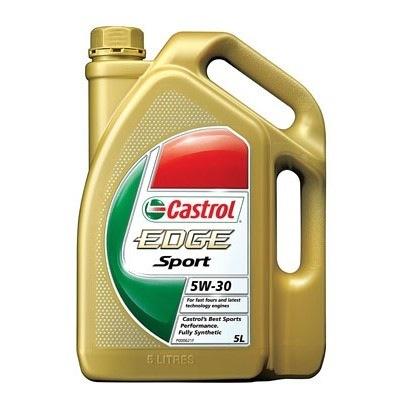

                          • It's different oil. For anyone else reading this Castrol Edge SPORT does not meet VW engine oil requirement specs 504 or 507 and if indeed you do put this oil in your engine and you have oil related engine issues, vw will void your warranty. Would they go to the trouble of testing the chemical composition of the oil? I don't know, but would anyone like to risk it.......?
                            The reccomended oil is Castrol Edge, here is a picture of the bottle:
                            This is the product that supercheap sell which is Edge SPORT:
                            Guy, I'll have to double check, see if they do sell the proper stuff now.....
                            • Castrol sell and market different lubricants according to region;
                              - Castrol Edge 5W-30 (504.00/507.00) only appears to be distributed and sold in the E.U.
                              - Castrol Edge Sport 5W-30 (502.00/505.00) is distributed and sold in Australia, and probably the rest of Oceania as well.
                              Regarding VW oil standards, here you can actually use either;
                              - 502.00 : because Australian delivered cars are not on the LongLife service regime (variable intervals), or;
                              - 504.00 : because 504.00 spec supersedes the older 502.00 spec.
                              Naturally, given the choice I'd recommend using the newer 504.00 oils, as they were specifically designed for FSI/TSI/TDI engines.
                              Also note, that you don't have to use Castrol exclusively - you can use any brand of lubricant as long as it has been formally approved by VAG.
