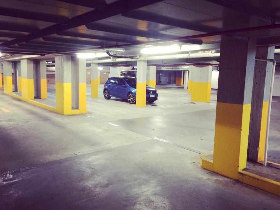

                      • Avoided the Boxing Day parking lots... Joys of working in the city. Got some new threads too....

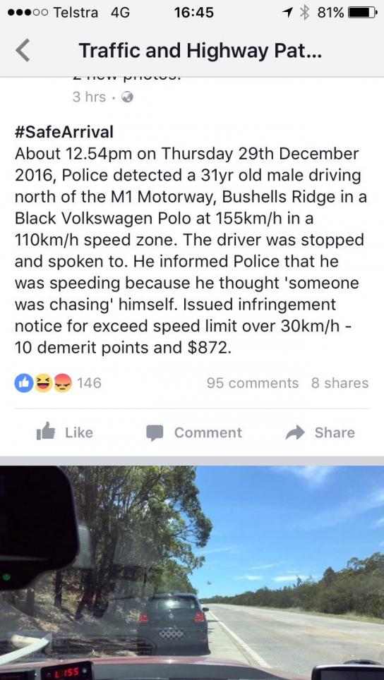

                          • Perfect...."I did 155kmh near Wyong"......
