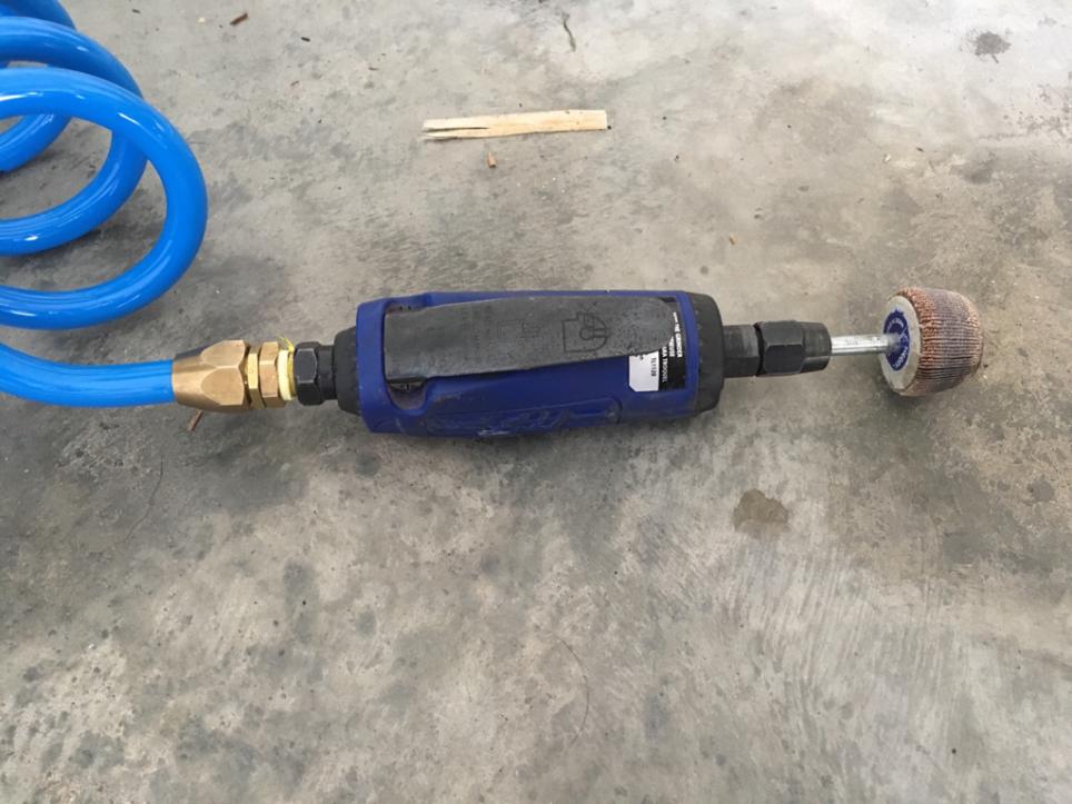

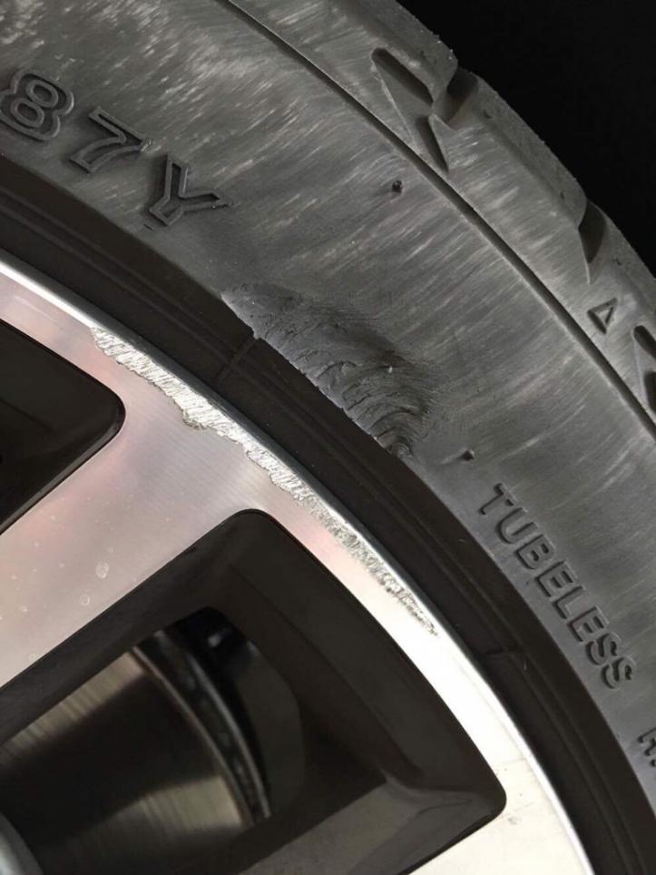

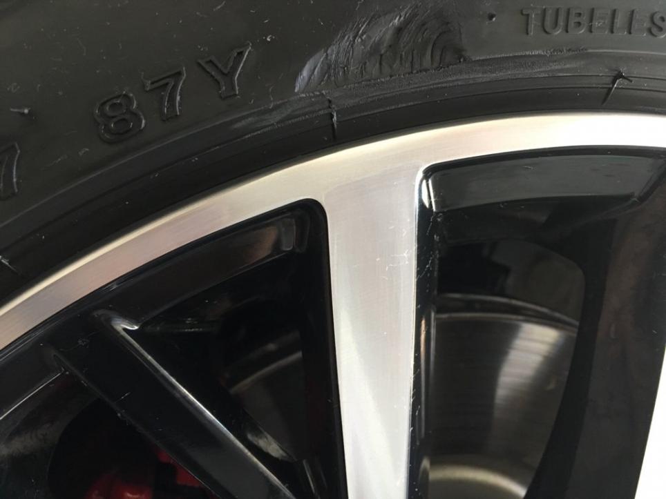

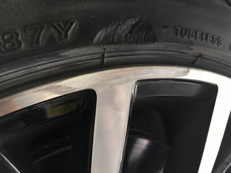

      So my wife did this he other day
      Wow, impressive Did you just polish it after you sanded it down?
      • Originally posted by wrecksigge View Post
        Cheers, I basically got it contoured as best as I could with the die grinder then wet sanded with various grit until smooth. I tried my polishing wheel but it ended up shinier then factory and stranded out so I ended up wet sanding with 800 grit trying to blend it as best I could matching the machined finish.
        Hopefully with time the alloy that Ai worked will dull slightly and match the factory finish.. Wishful thinking!!
        • Originally posted by najje View Post
          Yeah well based on the last Picture you posted you can barely see where the damage is!
