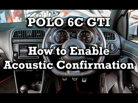

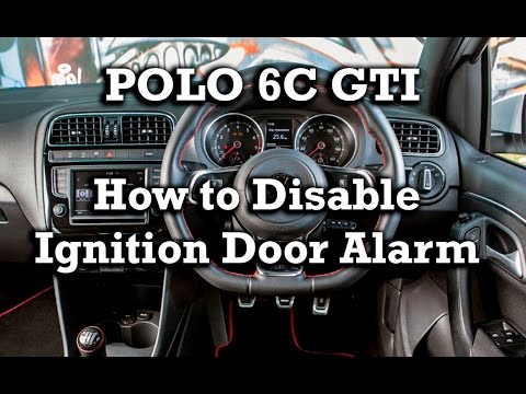

                              • Made a couple more videos today.
