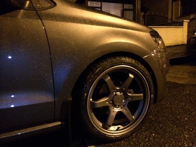

                        I'm just going to paint through the 'spokes' so i'm painting what you can see. Hopefully it should be easily doable! I'm not going to go wild with paint as I don't want drippage into the alloy and stuff. I just want this hideous rust to go away. Should be alright as the spokes are pretty gapy! (which makes my drum brakes look even worse!) P.S I know the photo is dark and rainy - but this is Ireland..

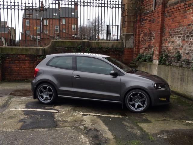

                          • So I painted the drum brakes black today (they were HIDEOUSLY rusty). Car looks pretty good now I think
                            P.S I took this photo in the shadiest car park in all of Belfast City ! :p
