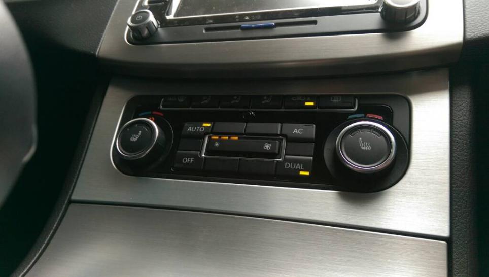

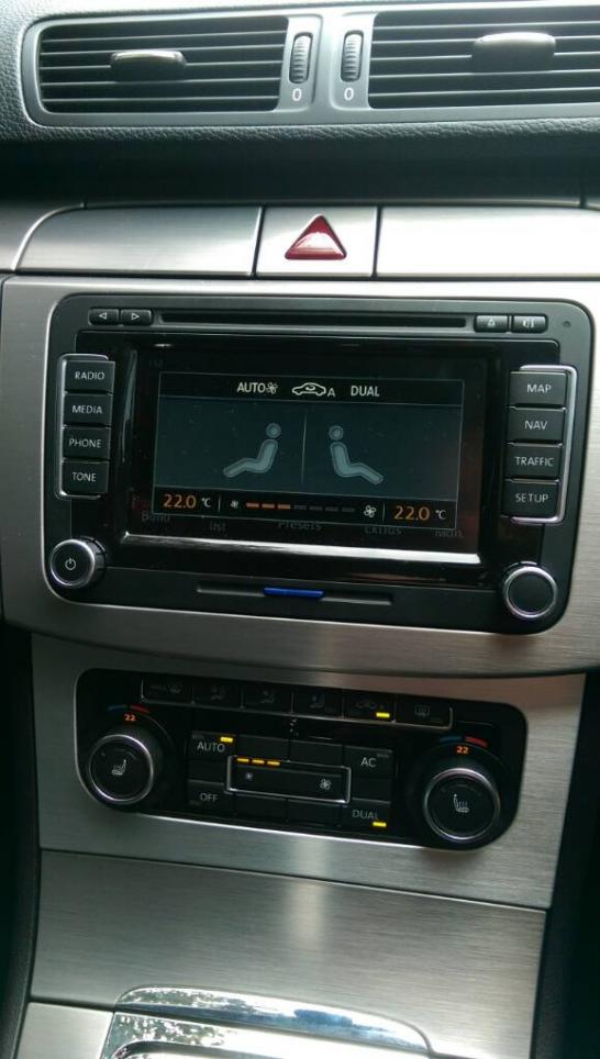

Install was easy.
Pop off the trim, 4 screws hold it in.
3 plugs to remove then put new one in.
Run flap motor adjustment (hold down front vent and AC buttons 5 seconds) and then compressor init (hold down rear demist and AC 3 seconds).
Adjust coding (main thing is turn off humidity sensor)
Dual stage auto works as does every other function.
Only issue I have is the AC is starting when car is started even if it was off (remembers all other settings in use).
I'll look into and fix that.
