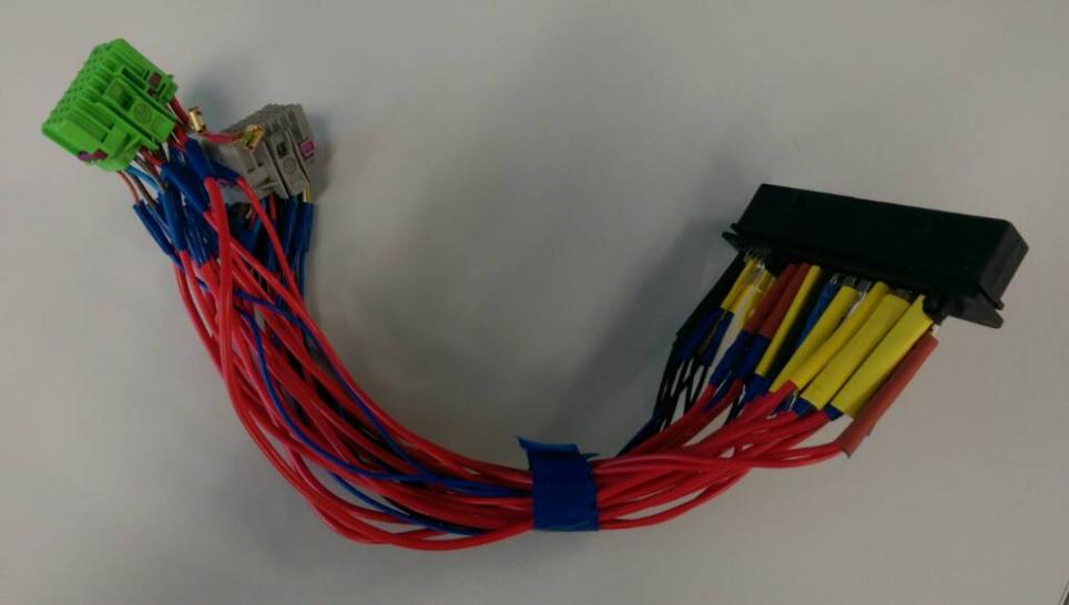

        • Here is the frankenharness. Just need to shrink the heat shrink

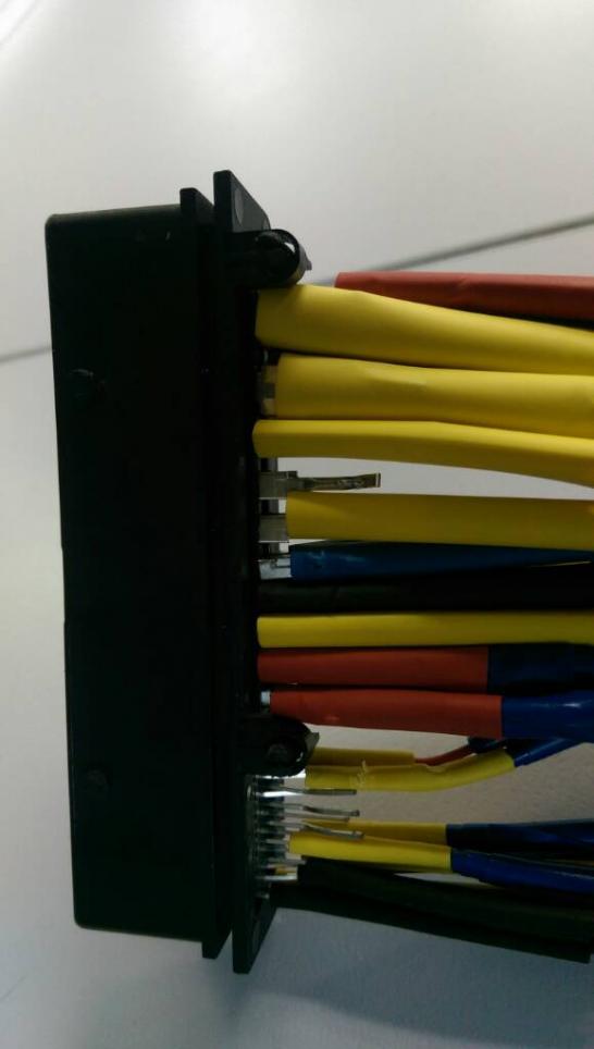

          Here is the original amp connector I desoldered from the board and cut off the 90 degree bends from the pins.

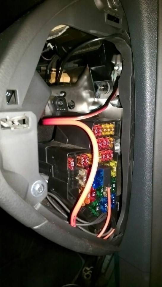

          And here is the ground and 12v I pulled from the fusebox on the drivers side. I used a 15amp piggyback connector in a spare slot.

            And the pic for the fuse box doesn't appear to be in the post?
