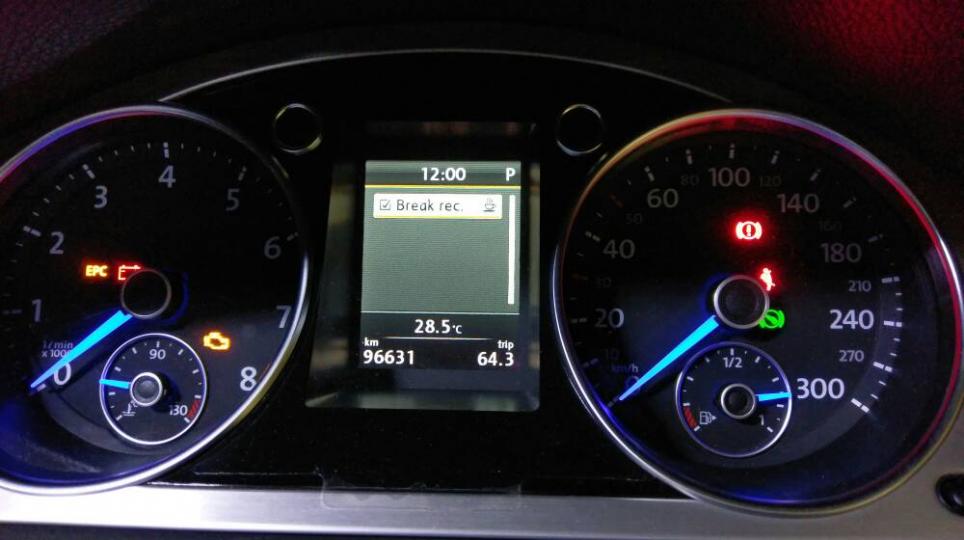

After some trial and error (try one coding string, check faults, add 1, try new code etc) with some advice from a friendly fellow enthusiast in Estonia, I was able to find a valid coding string which allowed me to clear the faults from all the modules and restored ABS/ESP/EPB functionality.
Next step is to relearn the keys and I will eventually have to do a wiring mod to the steering column lock module to clear a fault from the immobilizer. But this is a bit of a pain as its right down the bottom of the steering column so I'll have to leave that for a later date when I have some more time.
