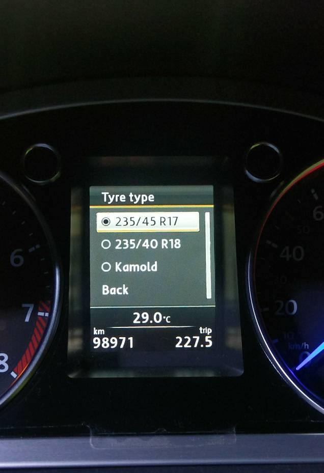

        • Custom data set applied to the TPMS module

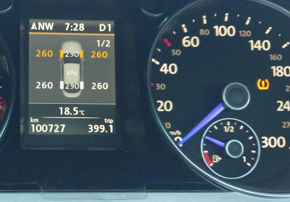

          • This is what a warning looks like with tpms direct.
