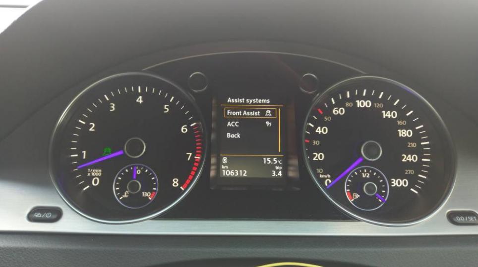

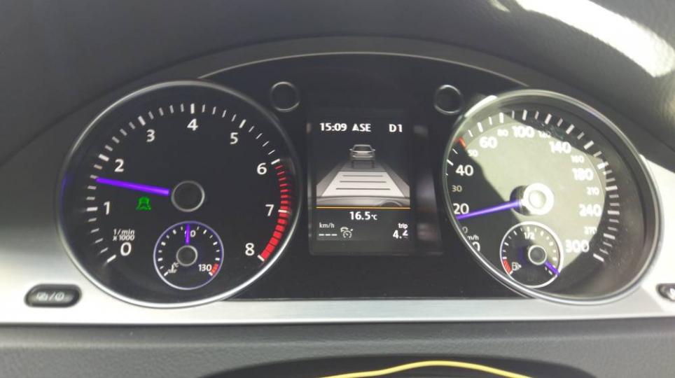

            • Adaptive cruise control with front assist installed and working!
              Car is still a mess because I need to reinstall the new centre console but this has been a huge journey for me and I don't have time to get it all back together until next week.
              A more detailed write-up to come but needless to say I've learnt a lot!
              • That certainly looks different to the B6 Adaptive Cruise Control. Have you put the B7 system in to work with the later MFD? Is that why you needed to move the Parking brake location? In my B6 the ACC and Front Assist are on different menus and you need to switch on the Front Assist independently to the ACC.
                Have you replaced the Cruise Control stalk so that you have the distance toggle switch on the top of the stalk? I see so many R36s advertised with ACC, but when you look at the stalk you know they just have the standard Cruise Control.

                • Yes I had to replace the centre console with the B7 version to get the newer Electric park brake switch in order to be compatible with the B7 ABS module I installed.
                  I had to get the B7 ABS module to be compatible with the B7 Comfort and Convenience Module.
                  I had to install the B7 CCM to be compatible with the upgraded cluster.
                  B7 ABS is also easier to get and can be modified to ACC capable from regular version.
                  Newer ABS also has newer software as does the B7 radar.
                  Had to upgrade to new instrument stalks to get the ACC switch with distance control.
                  Was quite a journey will post more details soon...

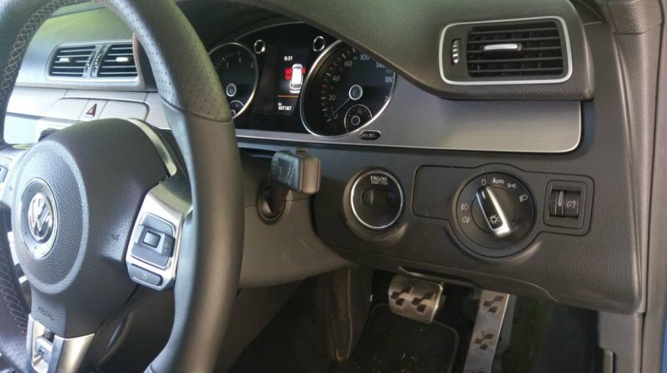

                          • Bye bye B6 electric park brake switch.
                            Hello B7 AC vent trims

                              • Originally posted by Passat R36 View Post
                                you just can't stop....
                                This is true...
                                Though I had to change the trim to get rid of the old park brake button otherwise it will confuse people when they drive it.
                                And seeing as I was getting parts out of a B7 anyway I thought I may as well get the new AC vents. They are also illuminated at night which is a little nicer.
