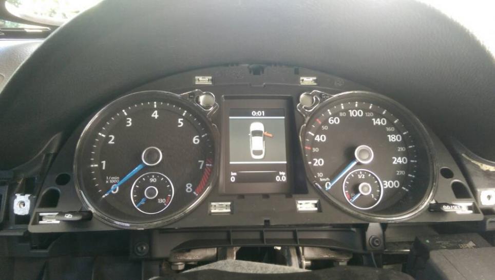

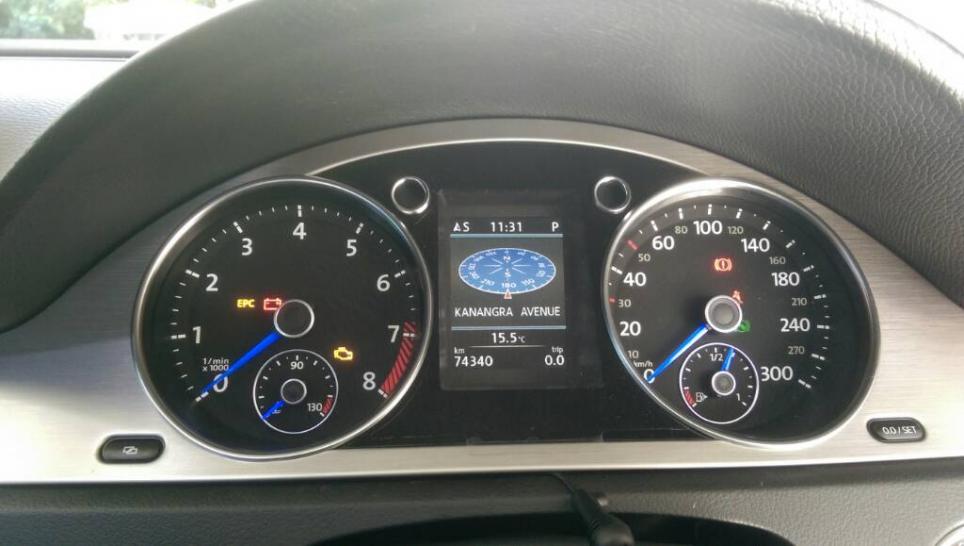

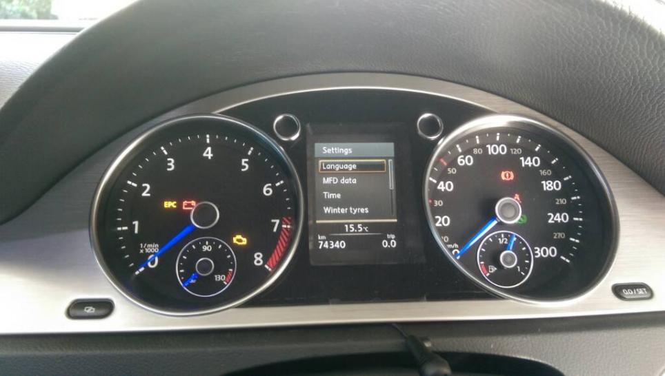

As expected, I've lost comfort and lighting controls via the MFD (now MFA+) however I can still control these via vcds.
Warning! My Rns freaked out and wanted me to input the security code after the cluster install. As mine was factory I had to 'find' the code using setconfig via the debug/multimedia port on the rns. If you don't have this make sure you have your code before installation.
And I have staging! (needle sweep at startup).2011 Skoda Octavia vRS TDI DSG wagon|Revo Stage 1|Race Blue|Leather|Dynamic Xenons w 6000K|9w7 BT|THA475 Amp+active sub|Whiteline ALK|RVC|
Niiice! Looks good, man. Jealous of staging for sure, would rather have that than the comfort/lighting settings as I have VCDS. Did you get any other new/lost functions on the MFA? Maybe I should put this down as a future mod, what did it cost in the end?
It's a second hand cluster. Talk to The Retrofitters if you need a price. No new functionality, just pretty.2011 Skoda Octavia vRS TDI DSG wagon|Revo Stage 1|Race Blue|Leather|Dynamic Xenons w 6000K|9w7 BT|THA475 Amp+active sub|Whiteline ALK|RVC|
You need to input the correct kms as is also stored in the ecu.2011 Skoda Octavia vRS TDI DSG wagon|Revo Stage 1|Race Blue|Leather|Dynamic Xenons w 6000K|9w7 BT|THA475 Amp+active sub|Whiteline ALK|RVC|
