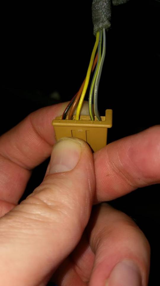

Found an issue with the mirror controls: folding control and heating are swapped over. Will switch the pins over in the module at some point. Just fyi
The pins which need to be swapped from the rotary switch connector are pins 3 and 5.
Here is the factory wiring configuration before swap:
Last edited by kamold; 30-12-2016, 01:09 PM.2011 Skoda Octavia vRS TDI DSG wagon|Revo Stage 1|Race Blue|Leather|Dynamic Xenons w 6000K|9w7 BT|THA475 Amp+active sub|Whiteline ALK|RVC|
