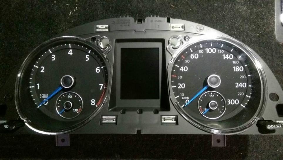

                          So this arrived today
                          Fingers crossed for compatibility!

                              Hint: it's the title of the thread
                              • #75
                                Well, never saw a R36 comes with colour MFD.
