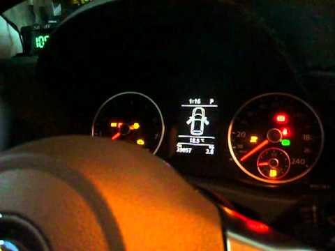

                  Has anyone been able to enable the needle sweep function?
                  I've had a look but can't seem to be able to activate the setting.
                  The option is under 17 instruments >> 10 adaption >> staging
                  However when I go into staging it comes up with some sort of error message so I'm guessing that function isn't supported in my instrument cluster... either that or my cheap micro-CAN cable isn't able to do all the functions (though I actually suspect it's the cluster).
                  - Tigger73's 125TSI Build
                  • #54
                    Hey Tigger,
                    For some reason it's not called staging on some cars, it's under "indicator presentation" or something like that.
                    I managed to get it to work under that, staging just doesn't have any options in VCDS for me.

                      Hmmm - went and had another look this morning and all I can find is "staging" and when I select this it comes up with "Error - unavailable" . Any idea where you found this option? Had a look in a few other modules other than 17 Instruments but couldn't see anything.
                      I have been able to run a "test" and get the needles to sweep but can't find an option to do this on start-up.

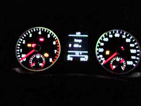

                        Cluster Staging / Celebration: (aka the needles dance / gauge sweep)
                        Instruments ----> Adaptation
                        Select "indicator_celebration" from the drop down list
                        Select "Active" from the lower drop down list

                              It won't work on some clusters.

                                Works on mine!! Thanks a lot guys
                                Tigger, instructions in above picture works on mine.
