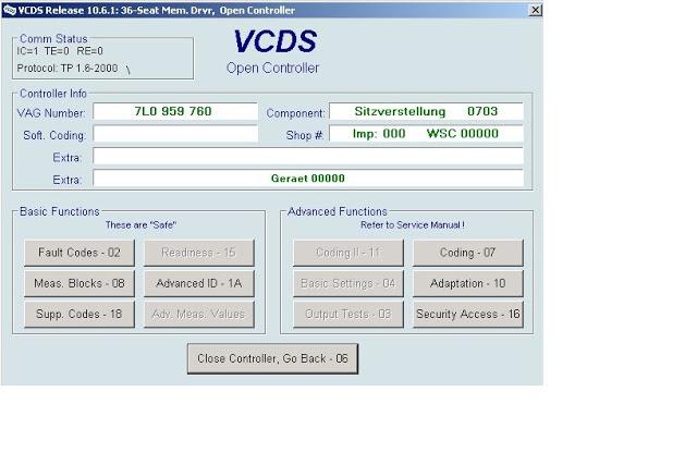

                    Hey all,
                    Has anyone with a MY11 Tig been able to get Side mirror dip to work when in reverse?
                    I can get the option to appear in MFD using VCDS but nothing happens to mirror when in reverse?
                    2011 Tiguan | 147TSI | Deep Pearl Black | Corn Silk Leather | Panoramic Sunroof | DSG (7-speed) | 4Motion | Bluetooth | MDI | Reverse Camera | RNS510 | 18" New York wheels | Premium Floor & Boot Mats | VCDS Micro CAN

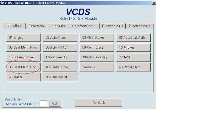

                      Sorry, just realized that others have noted the problem with the "dip side mirror" coding.
                      //- On a side note... I enabled the "Beep on locking" code which added the option "ATA Confirmation" to my convenience menu however did not add any horn noise when locking the car so I went back not VCDS to disable that one bit, confirmed the code string was 100% matching my initial scan of module 9 however the "ATA Confirmation" option is still in the menu (only difference is you cant turn it on or off)
                      Seems strange to me that it is doing this, any suggestions? If it's not going to work, I'd rather the option not be there. -// note: I was able to get rid of the stuck ATA menu item buy just leaving the car for 20mins
                      For the people who have this working, do you have the optional security system? (I don't, perhaps that's the problem!?)
                      Cheers,
                      Supervisa
                        Yes mate ... you do actually need to have taken out the factory "alarm" option for the beep to work.
                        I've noticed most people don't tick that box!
                        From memory, it's a $600 option and gives you motion sensors and siren.
                        Admittedly, VCDS coding description is a bit misleading!
                        Actually "beep" sound comes from the siren and NOT the horn from your steering wheel.
