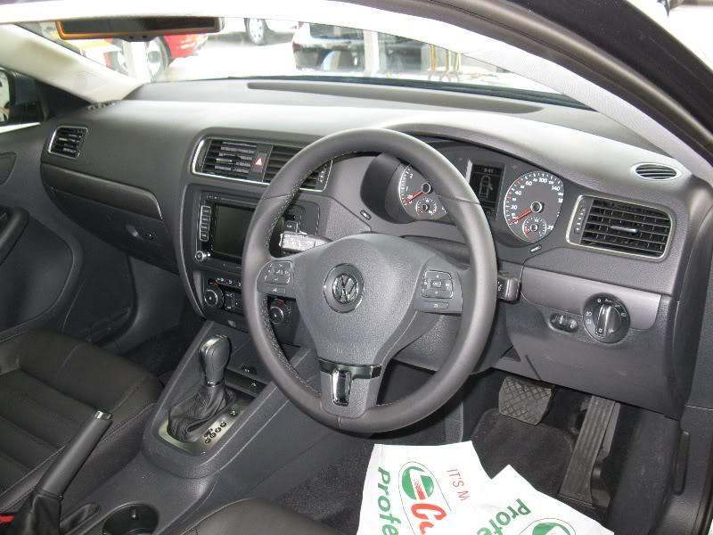

        Thinking of retrofitting my Jetta with a paddle shifter wheel. Looking at the eBay seller from Ireland. Anyone know if that will fit in an MY12 Jetta? I'm not very technical in this but is there a "one size fit all system" when it comes to steering wheels?

        • #34
          Suggest you post a pic of what the current steering wheel and MFD looks like on the MY12 Jetta.
          Can give you my best guess-timate from there!

            Took this pic from "phaeton's trip to the dealer" edition. Exactly same as mine!
            Emailed the eBay guy (from Ireland) and he said he's out of stock for the DSG. I asked if it'll fit but he didn't answer that question. Best price is AU$600 including shipping, it's listed on ebay for AU$610 + $80 shipping.
            He's definitely legit yeah?
            MY12 147TSI Jetta DSG | CW | Sports Pack | Sunroof | Driver Electric Seat | RCD510 | Formula 1 Tint | MFSW Paddle Shifters
            • #36
              If you look through this thread I think you'll find you have the same wheel that I started off with (although the colour looks a tad different). You should be fine.

                Yeah it looks pretty much the same wheel, which is a good thing. I'm looking at getting exactly the same paddle shifter wheels as yours, without the R/GTI badge.
