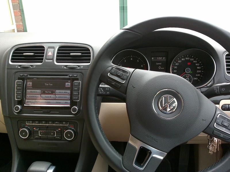

NOTE: Shape of airbag casing not compatible with Mk6 Golf MFSW
Existing Tiguan MFSW
NOTE: Whilst shape is different and without paddles, buttons are exactly the same as Mk6 Golf MFSW

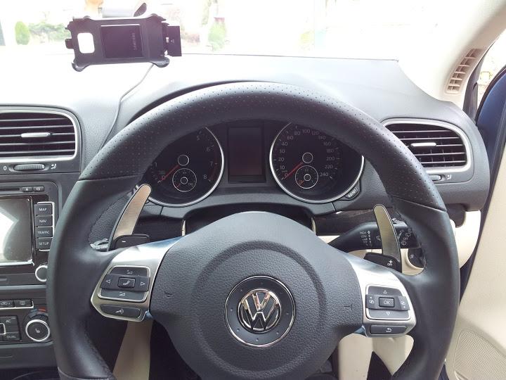

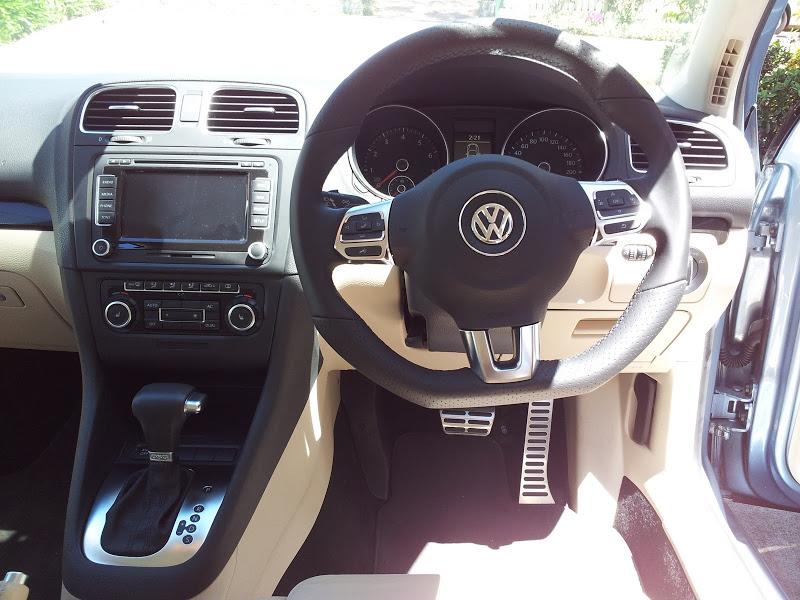

But fortunately for me ... the luck of the draw resulted in a chrome with black 'GTI' badging which (you'd have to agree) goes well with the rest of my interior pictured above.

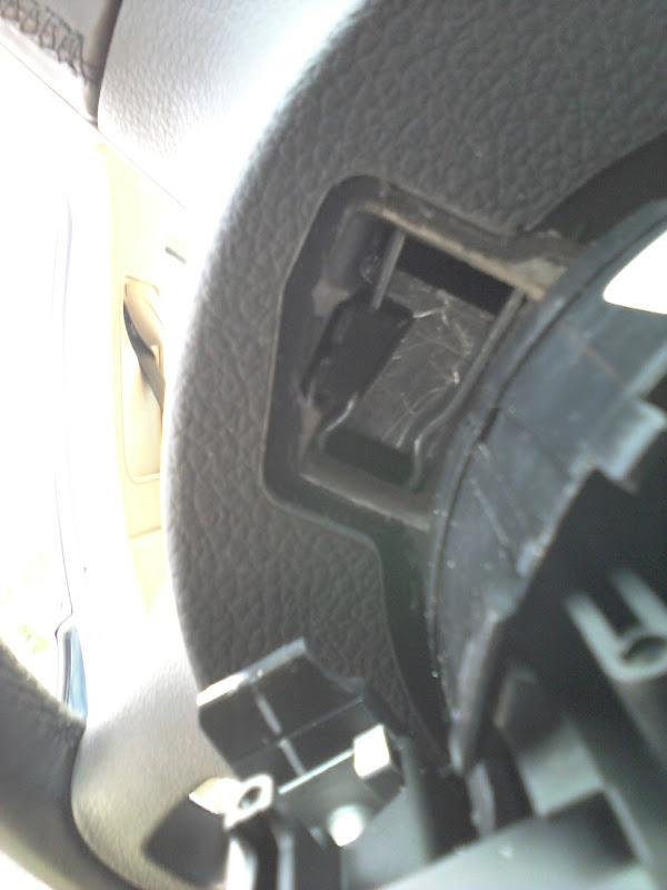

Hardest part is removing the airbag. Bitch is fitted on very tight at factory, with the clips refusing to budge without brute force.
Also the 4 spring loaded white cups on the airbag fit very snug in the 4 grooves on the steering wheel.
You will need two decent size flat head screwdrivers. One to push and permanently keep the clip to the left or right depending on which side (step 1) and another to push the top of the clip down and towards your face (step 2).
It would also help to have an extra pair of hands to pull the front face of the whole airbag while you perform step 2. But the key is to only get the other person to pull when you're absolutely sure you have the clip going through the hole during step 2 as shown in the second pic.
