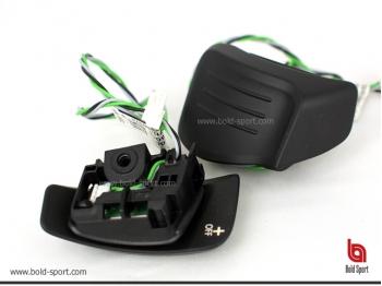

                            • DSG Paddle shifters - retrofit paddles????
                              I've seen these paddles, however not sure if you can just bolt them onto an existing steering wheel without paddles or not....
                              They're available here:Bold-Sport.com :: DSG Paddle Shifters
                              You can also get the MFSW control module: Bold-Sport.com :: Multifunction Steering Wheel Control Unit (Paddles)
                              - Tigger73's 125TSI Build
