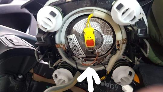

                        • How important is the earth cable from the horn casing to the back of airbag in the tig? My 2012 tig airbag has it but seems like the mk6 gti airbags don't.
                          What is it for and how would it affect operation if I were to install one without the earth wire?
                          Thanks

                          • All installed
                            Golf R MK6 DSG 2011
                            Airbag part # 5K0 880 201 L 81U
                            It came assembled with the correct harness as well, but had the older style clip plug to clock-spring. The only difference is between the yellow plugs from the older and new version is that the Older version is Spring loaded locking clip and the newer versions just have a plastic clip lock design.
                            DSG shifters work with simply one click long coding on obdeleven under the Steering Column control module.
                            Very nice swap over
