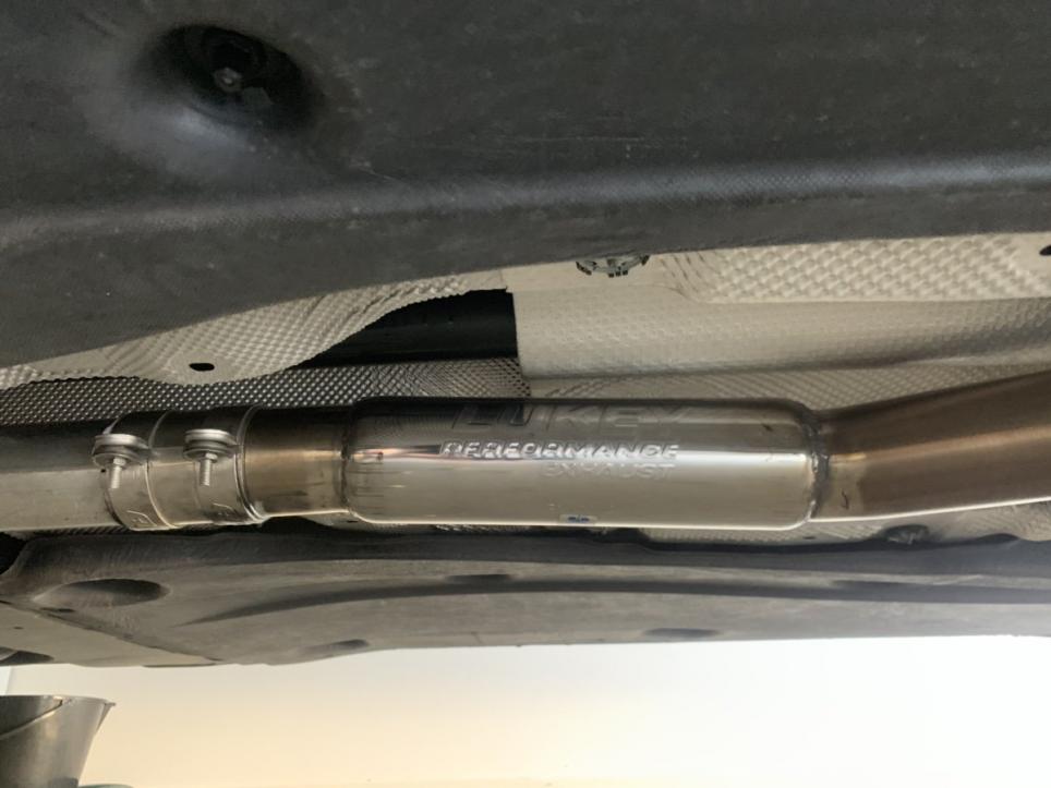

                        I’ve got the APR Stage 2 with Down Pipe, so found the system had a lot of “rasp” without being muffled, so we installed a 3” Stainless Resonator directly into the down pipe - this made it far more enjoyable and sounds even better as the system carbons up too!

                        • Interested to see some pics with the position of the resonator. Also details on the resonator if you have it. I have a Mk7 muffler in the shed which I'll fit in the next couple of months, however interested to find out what difference there is between the 7.5 and the 7. I thought there was just a slightly different width in the tips.

                                The resonator we used was a Stainless 12” long Lukey Performance, clearance was an issue fitting anything bigger without redesigning - didn’t want to cut the DP but was the only option. No major differences we were aware, the MK7.5 just became available first.
