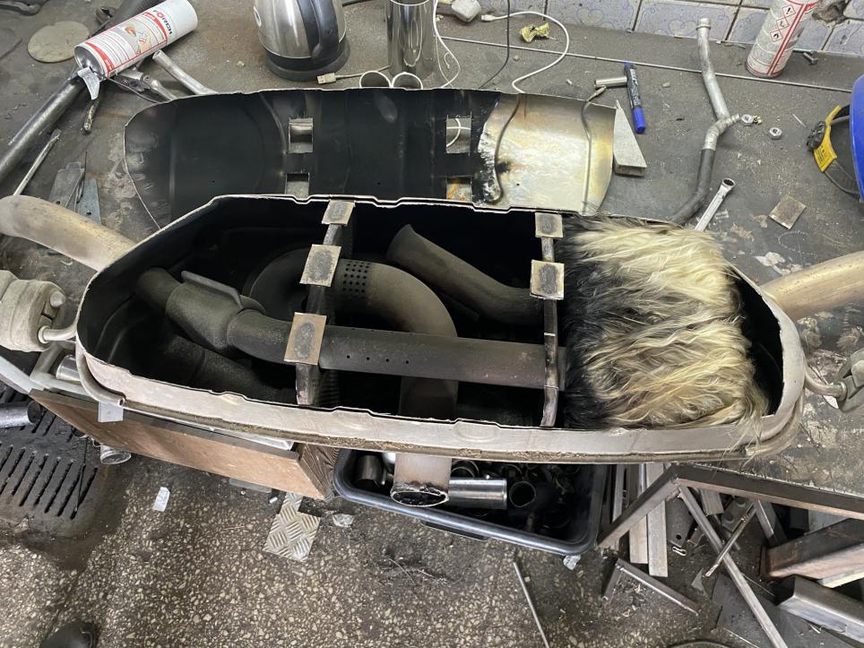

                        • Well, today I had open the rear stock muffler of my 220hp tiguan and what I found there you can see on the pictures
                          VW Tiguan 220hp, APR St.3 95 ver 1.1, IS38 874N, AFE Dry filter, REVO RV581M200800 Inlet Hose, ECS Tuning Muffler Delete, Wagner intercooler, Wagner catalysy 100-cell, Vibrant Performance Ultra Quiet resonator, Audi RS3 Flywheel, Audi RS3 DSG mount, ECS Tuning dogbone insert, Koni Sport shocks, 06K905601M sparks.
                          • Originally posted by Alexot View Post
                            Thanks for sharing this! No wonder the sound coming out is so muffled! Was there the same fibre insulation at both ends or just the one?
                            - Tigger73's 125TSI Build
                            • Originally posted by tigger73 View Post
                              Oddly enough it looks like it's just on one side going by the soot markings on the section that was cut out.
                              Sent from my Pixel 3 using Tapatalk
                                are you sure one of your neighbours aren't missing their golden retriever?
