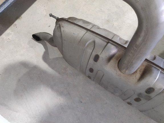

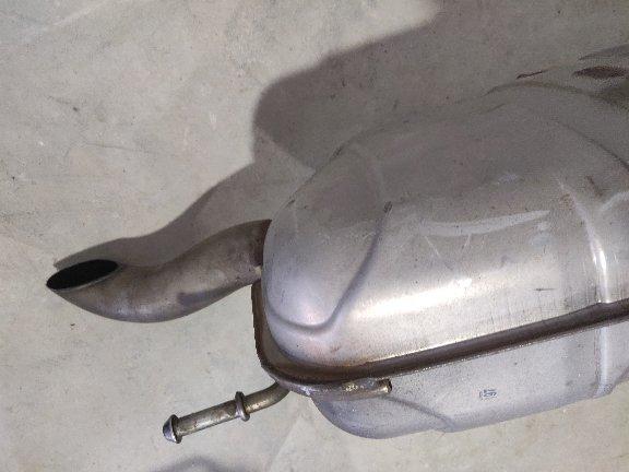

                • If anyone wants oem Tiggy exhaust I got my old one for sale in Sydney. $100
                  Good to modify, gut, experiment with
                  Sent from my ONEPLUS A6010 using Tapatalk
                  • Originally posted by daviboy View Post
                    Perhaps sell it to the Golf R boys as a resonator delete pipe. They can cut off the rear suitcase and all they need is a clamp to fit it.
