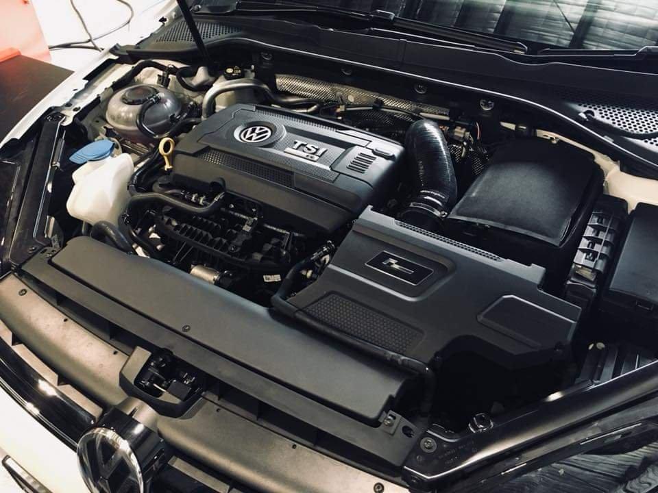

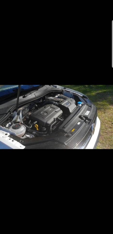

      There is an IS38 Tig out of Russia running an R600 intake and Wagner Intercooler, so this combo is tried and proven.
      Did you decide on whether you are changing the intake hose from the intake to the turbo inlet?
      I would hold of on Intake Hose unless 100% it fits Tiguan. I am learning the hard way that the intake sit close to the turbo than the mk7, see pics.

              Confirming the intake hose fits the r600 and also the stock airbox. The Russian Tiguan was running r600 intake, racingline hose and turbo inlet.
              I have used a MK7 GTI intake hose, by Ramair, on both my IS20 and IS38 and both fit fine (no kinks/abnormal bends).Note this is on a stock intake box and an APR turbo inlet.
              VW Tiguan 162 TSI Highline w/ R-Line & DAP. Mods: OEM IS38 turbo, APR IS38 98 RON ECU tune, TVS Stage 2 + with custom TCU tune, APR Downpipe and resonator delete, APR turbo inlet, VWR turbo muffler delete, APR pendulum mount, APR dog bone insert, APR Open Pod Filter (MQB), RAMAIR intake tube, APR Red Ignition Coils, NGK R7437-9 Spark Plugs, DBA T3 slotted rotors front and T2 slotted rotors rear, ATE ceramic pads front and rear Vbox: 0-100 4.1s

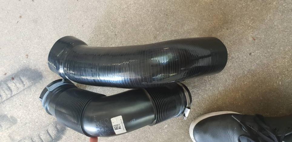

                  I picked up a Mk7 Ramair hose and it doesn't seem to like the R600. Might pop by Harding Performance and compare hoses.
                    Yes looks like a reasonable difference in length.

                      Racingline recommend using the intake hose with the r600 and refer to “power gains” although no dyno gains are listed. Its silicone so should flex with some minor engine movement. Although tiguan isn’t listed in terms of confirmed applications.

                      • Contacted Ramair, replacing as they believe it's defected.
                          Sent from my SM-G965F using Tapatalk
                          Your ramair hose does look quite bent when attached to the R600, I’m on the stock air box and it fits well for me. Hopefully your replacement hose is a better fit. Did you manage to check with Harding Performance, whether the Racingline hose is a better fit?
