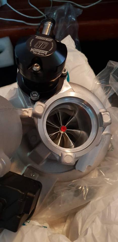

                      • Just been notified that my TTE475 has left the factory in Germany and should be here by the end of the week.
                        Intercooler has been ordered as well and just a few other smaller bits to collect...
                        - Tigger73's 125TSI Build
                        • Originally posted by tigger73 View Post
                          Excellent news!
                          Looking forward to reading more about the build, power and the sprint times!

                            • Didn't even think to update everyone until I saw a post in the Tiguan Facebook Page. I am all held up by the intercooler. Some crap between performance brand and Wagner and now I'm having to wait for Performance Brands shipment to arrive. Even though we went direct, they told Performance Brands to give me the one they had but they didn't have one or something. Anyway, it'll be the Monday after it comes. To think sorting out the turbo was my biggest concern..
                              Sent from my SM-G965F using Tapatalk
                              • I think I’m going to get caught up with the same issues. Ordered from Pacific Brands last week and still waiting...
                                Anyway a small update as another package arrived:
