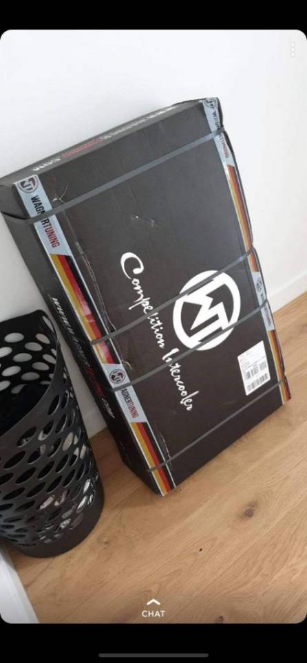

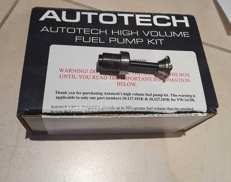

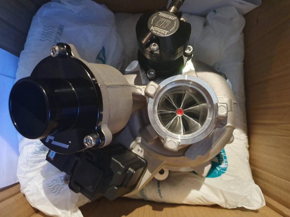

                  It finally arrived!!!

                    Tristan, this thread has gone luke warm for a while. Very exciting to see the intercooler, hybrid and hpfp come together. I look forward to your review and comments post your install on the 1 April.
