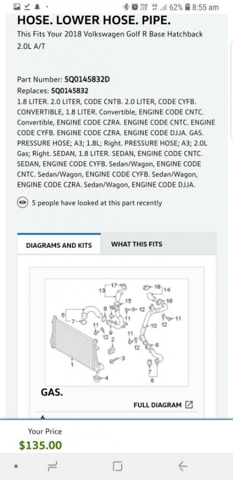

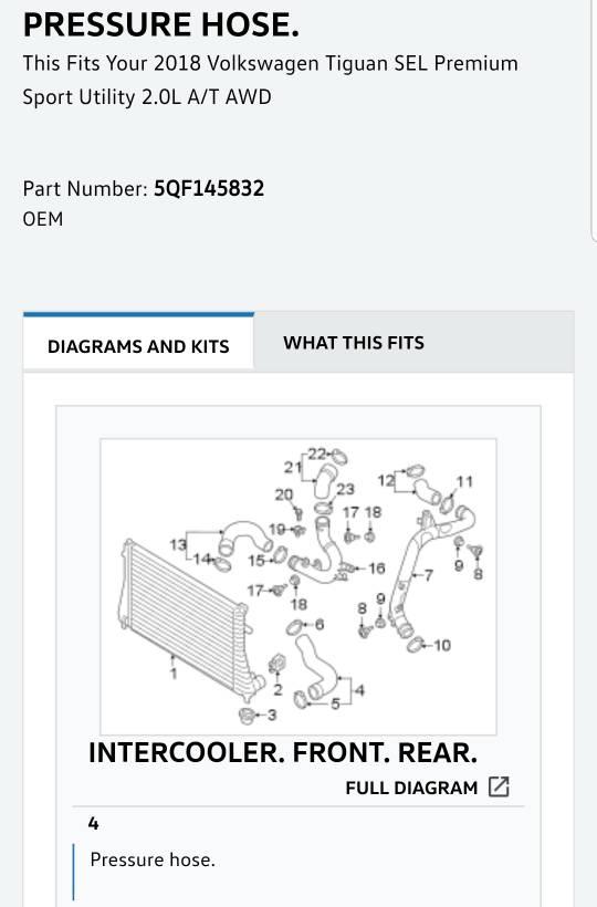

            There is a Tiguan in QLD that had a CTS intercooler fitted. I am waiting to hear back on what happened there. The CTS intercooler has enlarged inlets and outlets so I imagine the hoses that came with the kit would have been used.
            When it comes to Factory hoses, I was comparing Tiguan part to the Golf R. For example the left hose. Tiguan = 5QF145832 Golf R = 5Q0145832D (Originally 5Q0145832)

              I took a look at Tigger73’s Leyo link and they have Tiguan boost/Intercooler hoses, might be able to work with the IE Intercooler:
              LEYO Motorsport | Products - Cold Air Intake System
              VW Tiguan 162 TSI Highline w/ R-Line & DAP. Mods: OEM IS38 turbo, APR IS38 98 RON ECU tune, TVS Stage 2 + with custom TCU tune, APR Downpipe and resonator delete, APR turbo inlet, VWR turbo muffler delete, APR pendulum mount, APR dog bone insert, APR Open Pod Filter (MQB), RAMAIR intake tube, APR Red Ignition Coils, NGK R7437-9 Spark Plugs, DBA T3 slotted rotors front and T2 slotted rotors rear, ATE ceramic pads front and rear Vbox: 0-100 4.1s
              • IT Mechanical got back to me about the CTS Kit they fitted to a Tiguan. They used the CTS Hoses and it was fine, I think I'll risk the IE Intercooler and if it doesn't work I may have to pick up a set of those Leyo ones.
