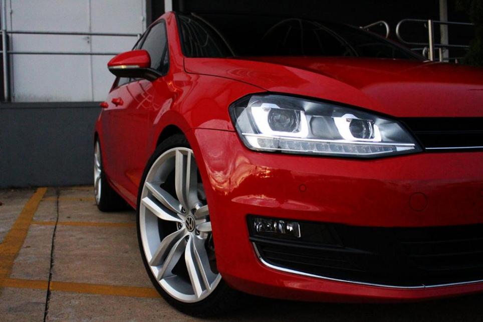

  • I just drove past a Taureg with these very same wheels this afternoon...

    This image is from over in the headlight thread I am curious as to what these wheels are? At first I thought they were Pretoria's but then I realised they are something else.
      Ok so VW do a 20 inch wheel called the Pikes Peak as an option on the Touareg:

      I'm still going to run with my original idea that the wheels on the Golf are not OEMs, as the spokes on the Pikes wheels are a bit thicker.
      However for someone chasing an OEM wheel these are a fairly close proxy - for extra information I understand the Pikes wheels are manufactured by Borbet, and come in 20 x 9 ET57 which could be made to work on a Golf - where the issue will be is that the Touareg has a 5x130 PCD v 5x112 PCD for Golf which would require adapters and illegal fitment.
