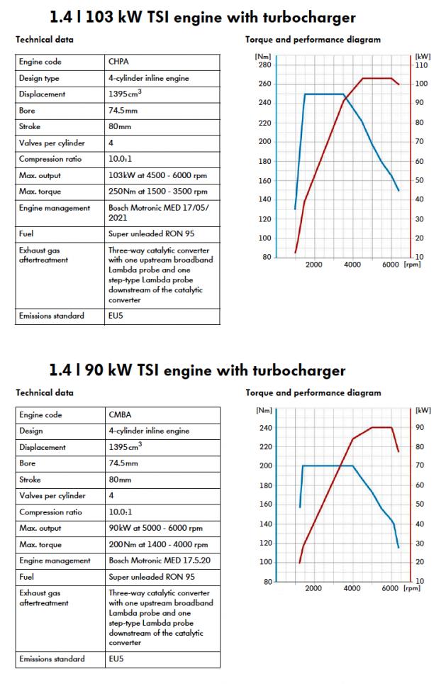

                      Hey guys, I've done a bit of searching online trying to find out what the difference is between the 92TSI & 110TSI in regards to how the power output is achieved. From the spec sheet on the Volkswagen website both engines are
                      - 1.4L 4 cylinder Turbo
                      - 1395CC capacity
                      - 80mm Bore Stroke
                      - 10.0:1 Compression Ratio
                      - 95 Premium Unleaded minimum Fuel
                      Everything engine size wise is the same between the two. Could the 92Tsi just be "de-tuned" or the 110TSI be tuned.
                      I have read the same thing being the case with the new Tiguans I believe, where the is 132 is allegedly just a de-tuned 162.
                      Any insight would be great, Thanks in advance.

                        Stack_City_Kid: Yes I suspect that you are entirely correct - they are basically the same motor but "de-tuned". Here is the information from the 1.4ltr TSI engine in my MY13 engine (which has exactly the same specs as your 110/92 TSI engines. Clearly the changed power response happens because of the different engine management system (see table)
                        Fact is that you can get just about any KW number that you like from a turbo (within reason) - it's just a matter of how much stress you are prepared to place on the engine components!!

                          Interesting,
                          Could this be due to something that happens during the engine building/ testing phase? for example an engine that shows signs of "stress" at a higher Kw rating would be de-tuned to a "safer" or more stable engine output, similar to what happens when they make computer CPUs? where they test and lock the chip to the highest safest CPU speed they can get out of it.
                          Also thanks for your feedback Don
