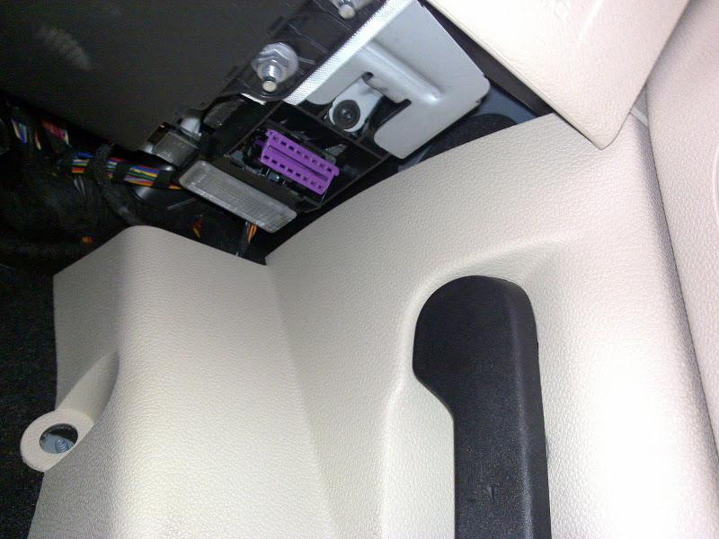

    After you have read the manual and followed the instructions for installing the cable drivers and VCDS software, you're ready to begin tinkering. Turn on your PC and connect the cable to the PC first (at least for your first time using it on this PC). Then plug the other end of the cable into the car's diagnostic port, located near the bonnet-release handle. A green LED on the cable will light up when the cable is connected properly. You will also need to turn on the car ignition. You can now breathe a sigh of relief that you purchased the correct cable.
    Figure 1: Connect the cable to the purple(ish) port shown above.

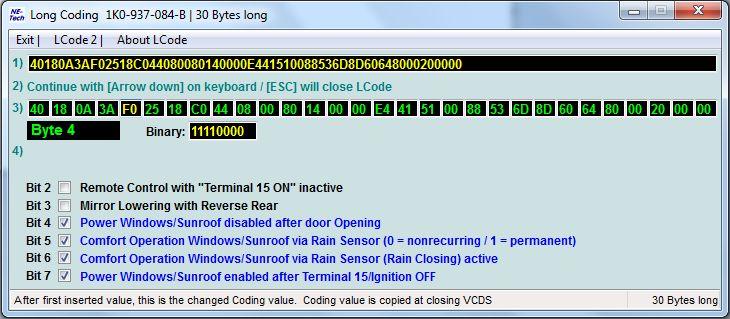

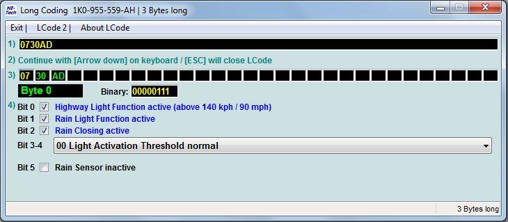

      Was (0 - BCM) - 40180A3A982518C044080080140000E441510088536D8D6064 8000200000
      Was (2 - RLS) - 0330AD
      Change - Enable rain sensor for automatic window close
      New (0 - BCM) - 40180A3AF82518C044080080140000E441510088536D8D6064 8000200000
      New (2 - RLS) - 0730AD

    1. Automatic closing of windows and sunroof when rain detected on the windscreen
    Credit goes to My-GTI.com, VWVortex.com and no doubt others as well.

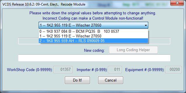

    1. Navigate to 09 - Cent Elec - Long Coding
    2. A drop-down list allows for 3 slave controllers to choose from. Keep the first one selected (0 - BCM) and click Long Coding Helper.
    3. Select Byte 4 and enable Bits 5 & 6
    4. Press Esc and click Do It.
    5. Click Long Coding again, select (2 - RLS) and click Long Coding Helper.
    6. Select Byte 0 and enable Bit 2
    7. Press Esc and click Do It.

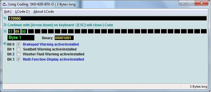

    4. Remove seatbelt chime/reminder
    1. Navigate to 17 - Instruments - Long Coding
    2. Select Byte 1 and untick Bit 1.

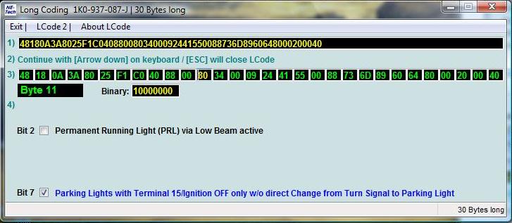

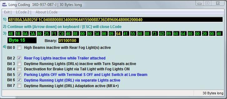

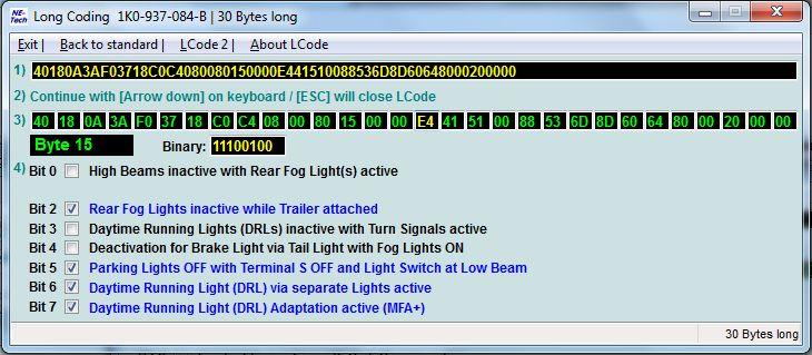

    6. Disable DRL's (Daytime Running Lights)
    Halogen (normal) Lights:
    1. Navigate to 09 - Central Electronics - Long Coding
    2. Byte 15 - toggle Bit 6.
    Xenon Lights: (thanks v0a)
    1. Navigate to 09 - Central Electonrics - Long Coding
    2. Byte 11 - Untick Bit 2 - This turns off Xenons light as DRL, all lights off when switch is set to 0 (off).
    3. Byte 15 - tick Bit 6 - This turns off Xenons light as DRL, auto turns on lights when dark, switch set to AUTO

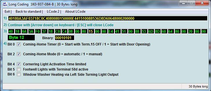

    7. Coming Home Lighting settings
    Navigate to 09 - Central Electronics - Byte 12

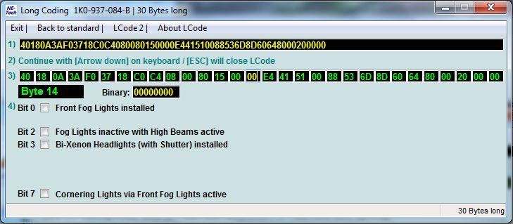

    8. Use fog lights as DRL's - I don't have Fog lights or Xenon's, so can someone else do this?
    i. For vehicles with halogen headlights (coming later)
    ii. For vehicles with xenon headlights (coming later)
    iii. Use fog and xenon lights as DRL's (coming later)

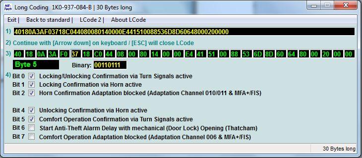

    11. Enable/Disble use of Horn and/or Indicators When [Un]Locking Vehicle
    2. Toggle the boxes shown. Using the horn doesn't work for all models (need factory fitted alarm option).

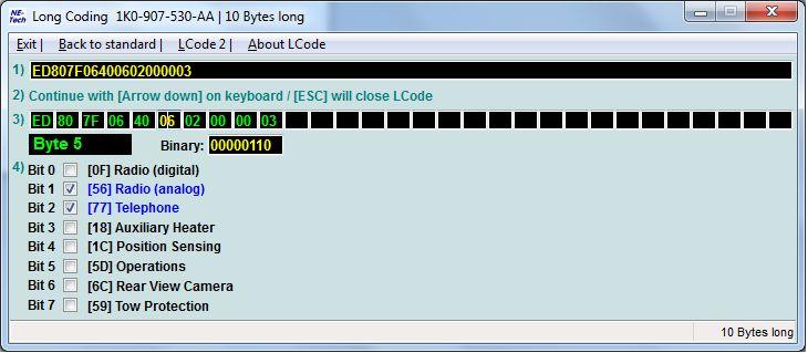

        2. Bluetooth w/ voice-control
        View Installation Guide Here | View Wiring Harness
        Navigate to 19 - CAN Gateway - Long Coding - Byte 5 - Enable Bit 2

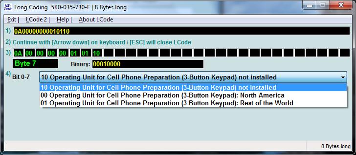

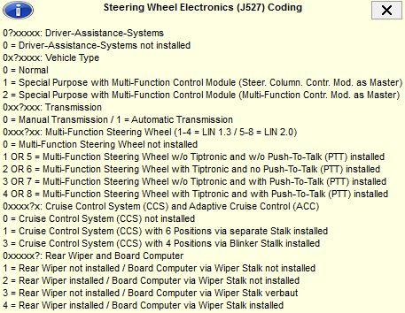

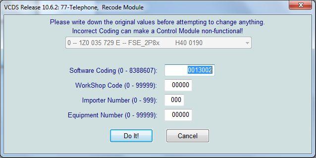

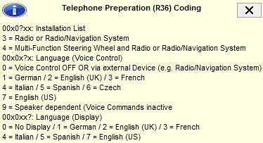

        Then go to 77 - Telephone - Coding - and enter in a code that matches your vehicle:
        Select if you have the 3 phone buttons in the roof or not (Navigate to 77 - Telephone - Byte 7)

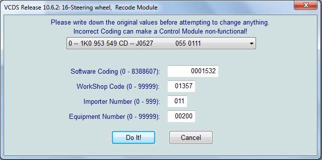

        Microphone Button on Steering Wheel
        Navigate to 16 - Steering Wheel - Coding | Note that the following also shows the code to change to retrofit a Tiptronic Steering Wheel
        Use the yellow Help tool-tip to work out the right code for you:

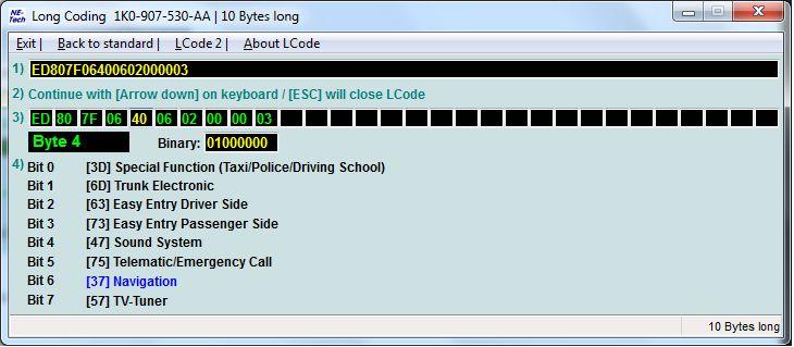

        6. OEM Reversing Camera (badge popup)
        Navigate to 37 - Navigation - Long Coding
        Byte 3, Bit 6 (ticked).
        Restart RNS510 after applying settings.
