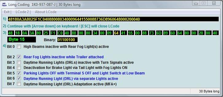

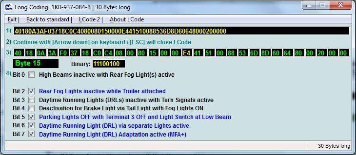

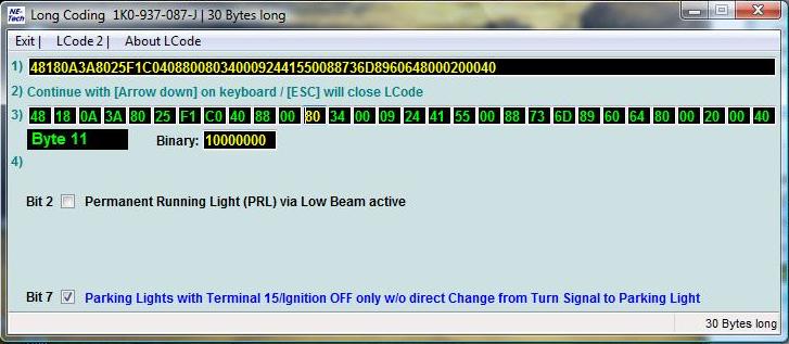

    5. Disable DRL's (Daytime Running Lights)
    1. Navigate to 09 - Central Electronics - Long Coding
    2. For vehicles with Halogen (stock) lights go to Byte 15. For vehicles with Xenon lights, go to Byte 11.
    3. For Halogens, toggle Bit 6. For Xenons, ???
    Just VCDS my car
    Byte 11 - Uncheck Bit 2
    This turns off xenons light as DRL, all lights off when switch is set to 0
    Byte 15 - Check Bit 6
    This turns off xenons light as DRL, auto turns on lights when dark, switch set to AUTO
