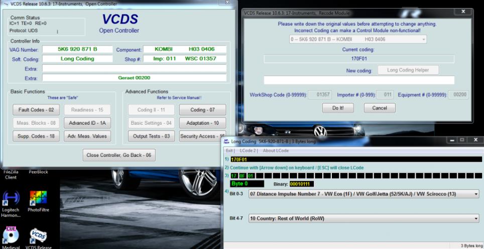

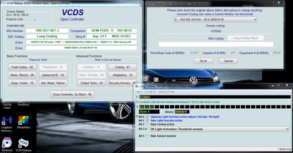

      I took a bunch of screenies today (but didn't really note down where to go to find those options, but I think I've got it ok). I'll let one of you new owners be a verifier as I didn't have time. Plus, I also need someone with xenons/fog lights to confirm some of the other options pertaining to those.

              I've turned on the sunroof + windows close when rain is detected (apparently will also close after the car has been locked for 24 hours but I haven't tested that).
                    I'm not game to test it out though lol.
                    • #25
                      Well, it's easy to "test" it. Just do the change, leave the wipers in "auto" leave the windows and sunroof open, lock the car, then pour some water on the rain sensor on the windscreen (I think you need to wait for a certain amount of time before pouring the water on).
                      But yeah - I'd still be nervous about leaving the car outdoors if it were going to rain...
                      • #26
                        just thought about it, having this rain closing feature turned on, whether it could pose a risk of arm decapitation if you decided to just roll down the window while engine off, waiting for someone? or is it 'on' only when the car immobiliser is armed & locked?
                        • #27
                          It's only on when the car is locked. If someone decides to reach into my car while I'm not around and it starts to rain I don't really care what happens to their arm (besides family I guess)

                              Automatic closing when rain detected works perfectly on my GTI. No need to wait 24 hours. Closes after pouring water on the rain sensor for ~5 seconds.
                              2010 Mk6 GTI / CW / 3dr / DSG / 18" Detroits / RNS-510 w/VIM! / RVC / Bi-Xenons / MDI / Euro Plates / 9W7 / VCDS Micro-Can / APR Stage 1
                              • #30
                                Pouring water on the rain sensor is how I tested mine.
                                The rain close feature will also close the windows and sunroof if the car has remained locked for 24 hours (or if rain is detected, whichever comes first).
                                So if you've left your car in long stay parking while on holiday, it will secure itself if you've left a window or the sunroof a bit open.
