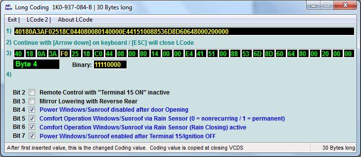

              • #67
                Originally posted by Ryan_R View Post
                Convenience Features/Tweaks
                Has anyone tried this mirror lowering in reverse rear on a mk6 Golf? I've had a look but I can't see Bit 3 in Byte 4.
                Golf GTD (170) 2010, 5 Door, Shadow Blue, Flat Tyre Indicator, Service Plan, Basic Protection Pack + VCDS.
                • #68
                  In Australia, this function is only available on GTIs/GTDs/TSIs with the Park Assist option. Otherwise the car is missing the necessary controllers.
                  • #69
                    Yeah you can tick the box (I have) but it does nothing since we don't have the hardware for it. I just set both mirrors to respond simultaneously to adjustments (the the knob is pointing to R), and then quickly lower both mirrors in one go while engaging Reverse gear with my other hand.

                    • #70
                      Thanks guys well I can't see that option on my UK GTD. The terminolgy doesn't look right Mirror lowering in reverse rear the reverse rear part.
                      Thats a bit over the top Ryan thats a useless feature anyway adjusting both mirrors at the same time, mine are set on individual.
                      • #71
                        I used to think the same and had them set individually, until someone at VW changed/reset it when the car was serviced. I find very easy to lower both mirrors together as I'm slowing down in preparation to reverse.
                        If you need to adjust individually, just get the right side how you like it (which moves both), then change to L and fix that side up, since both mirrors only move when it's pointing to R (or drivers side). My only gripe is that the left side doesn't always keep pace with the right side, so when I raise the mirrors again, the left side doesn't go up as much as the right side Perhaps someone else could test this to see if it's just my car.
