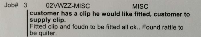

                  • rattle free!!
                    bit of an issue with the dealer though, as I supplied my own (OEM ofcourse) clip they initially refused to install it, anyway after I insisted they look into it further they eventually did.

                      Just a query.....I notice service tech says "found rattle to be quieter" and you say "rattle free"
                      Can you hear it at all now Vaku?

                        • Gtimk6,
                          Yeah the Rattle is completely gone!
                          Tested with all windows down, higher gear under load, next to other cars, pulling away from the lights etc
                          Basically everywhere I would normally hear it.
                          All you hear now is the turbo which was masked slightly by the rattle
                          I found it strange when I asked how did the clip install go and he said yeah it improved it slightly and seemed hesitant to even say that, then after I read the job list I thought oh well has to still be better than before :/
                          But nope, it's gone!! Improves the driving experience so much IMO!
                          Miilos, that's why I supplied my own clip cbf waiting - almost backfired when they initially said they would not install it though.
                          Thanks again to Corey for assisting to make this all happen!
